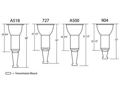

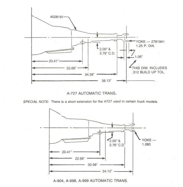

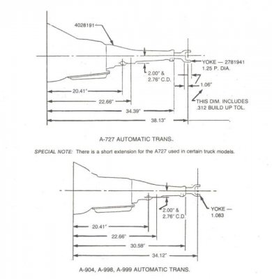

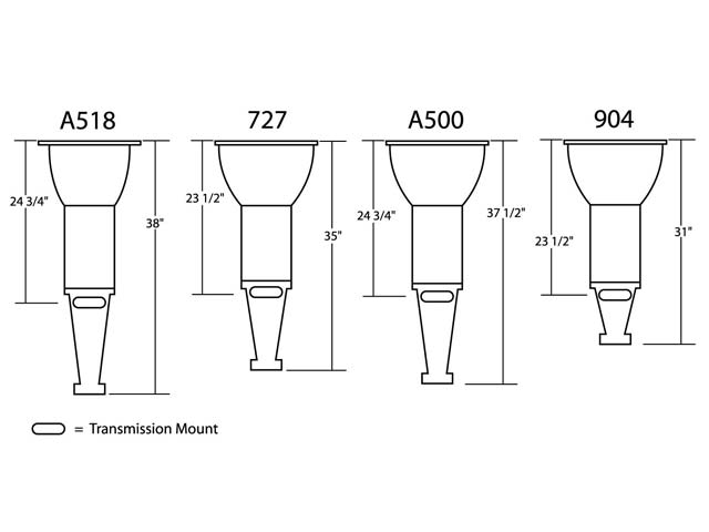

hello B people -can anyone tell me if there is a difference in tailshaft length between a 727 and 904 trans?
if so what would that be? thanking you all in advance
Geri
Hope this helps some...
PERFECT--THANK YOU,NOW i KNOW WHY THE DRIVELINE IS TO LONG AAARRGGGHHH.
