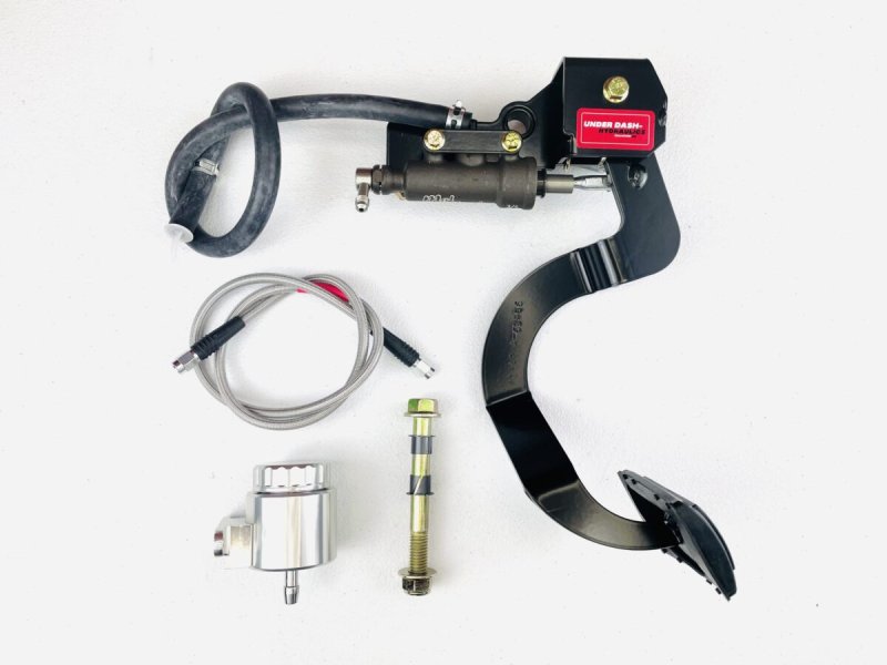

I've got the Mal Wood Underdash Hydraulic pedal unit so the only visible change under the hood is the small hydraulic reservoir mounted off the brake master cylinder bracket.

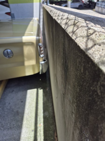

Day to day driving is fine, but reverse parking is a bit more challenging than before, twisting around to look behind while juggling the clutch. I've had two close calls recently in carparks, pure fluke I didn't hit the concrete the last time.
Holy crap that pedal is awesome! Thanks for alerting me to it. Much cleaner solution than the kind that mount on the firewall.
