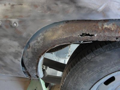

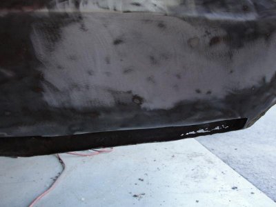

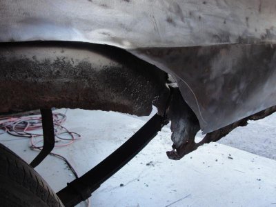

You can see from the pics below, the trunk drop off needs replaced. I've located a few panels so this should not be an issue. The wheel well concerns me more. Are patch panels available or is this a replacement type of project? Do they make aftermarket parts? Thanks in advance.
This is a '67 Plymouth Belvedere.

On my `66 I used parts from from Sherman. They call them 'trunk extensions'. For the 'outer wheel house' I purchased one for a `67 Dart as it was "close" to the same shape I only had one area that needed repair so the body guy simply cut a patch out of the wheel house and made it work. Unfortunately nobody is reproducing those panels yet. These body styles are just now being recognized as affordable muscle. I'm sure they will become available...about three years after I am done. Oh well. Good luck with your project!
