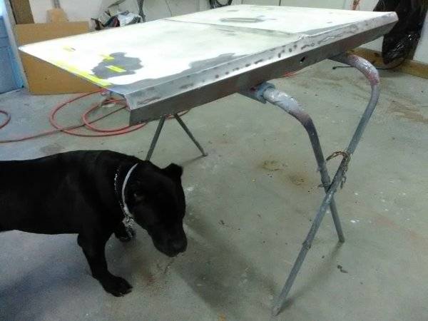

can anyone tell me the difference in a 1968/69/70 trunk lid on a Bee thanks Dave

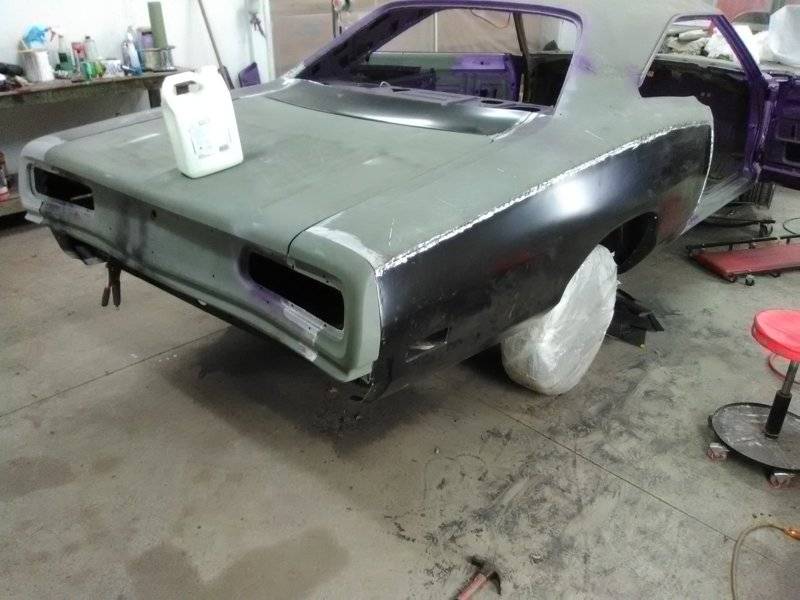

68 key hole in the lid
69 key hole in the tail panel
70 key hole in tail panel but different than 69
Bottom edge different also?

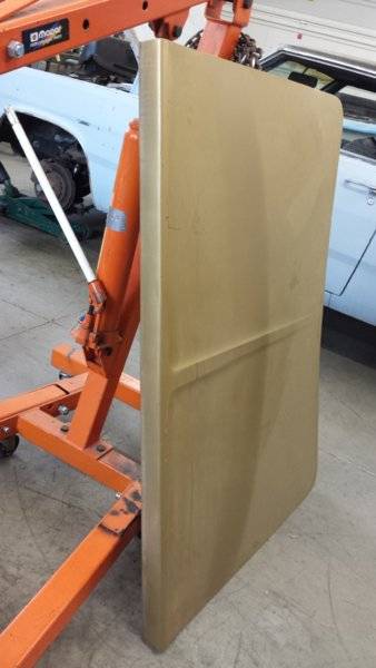

70
Wow...I had no idea that they used a different lid for each of those years. What a pisser.
If you check the under side of the 70 lids, there were 3 different ones. Some with cutouts for a spoiler and some did not have the center rib.
mine has the cutouts,yep love those 1 year only cars :BangHead:
