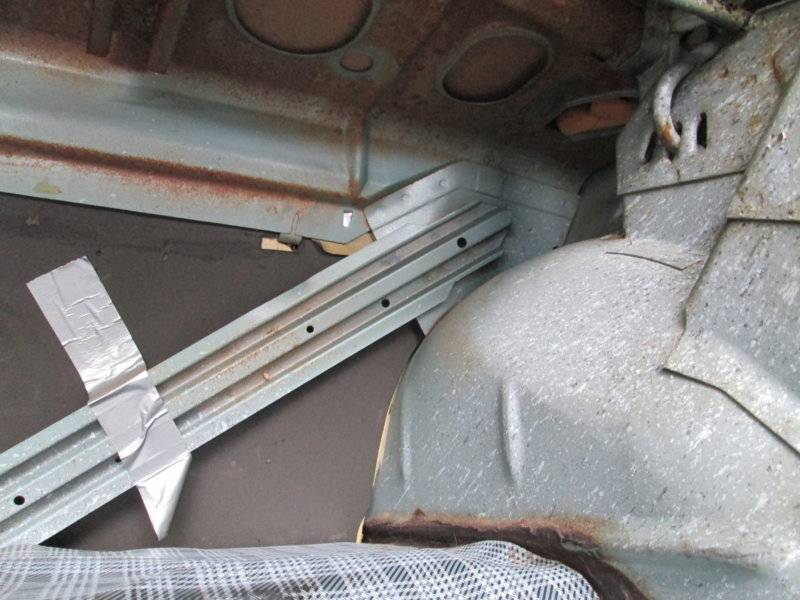

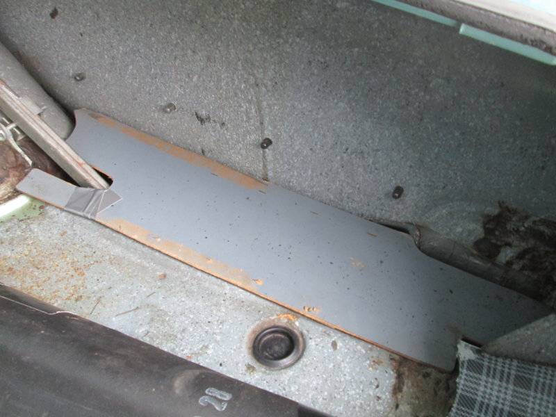

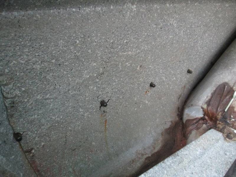

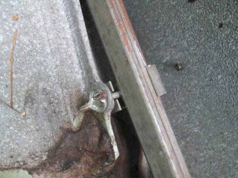

Here's a few pics from my '65 Coronet survivor. I don't have any with the trunk mat removed, as it is cracking when I try to move it. The paint is gone off the original sealer in spots.
I plan to touch it up a bit with some over spray, but not too much...
