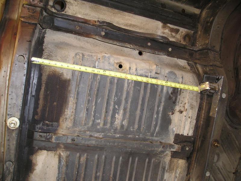

Does anyone have measurements to where these get welded on?

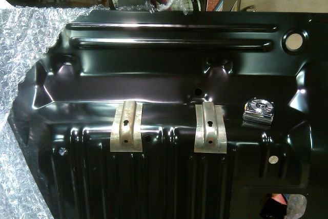

Yeah I am getting ready to weld my new AMD ones on my pan here this next week, I still have my old floor with the originals attached I will measure tomorrow.

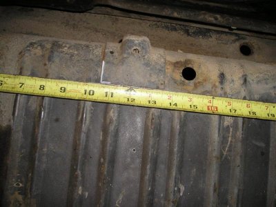

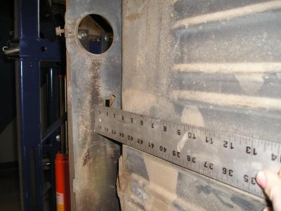

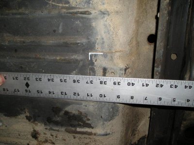

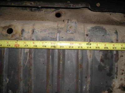

Here, hope this helps. It's a '68 Sport Satellite
The measurement is taken from the inside of the right (passenger) frame rail. Keep in mind that the center of the brace is square to the hole in the rear valance. The overall position isn't all that critical, but ensuring the centers are the same will keep the gas tank straps from looking pinched.

Thanks for the great pics, very helpful. You also inadvertantly gave me the shock crossmember measurement I also needed. Thanks Again!:icon_sunny:
