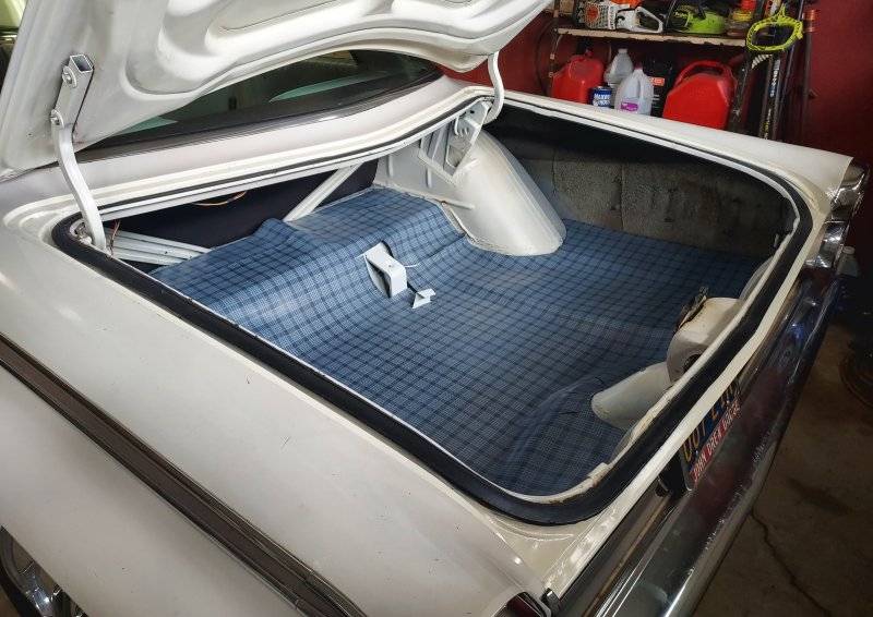

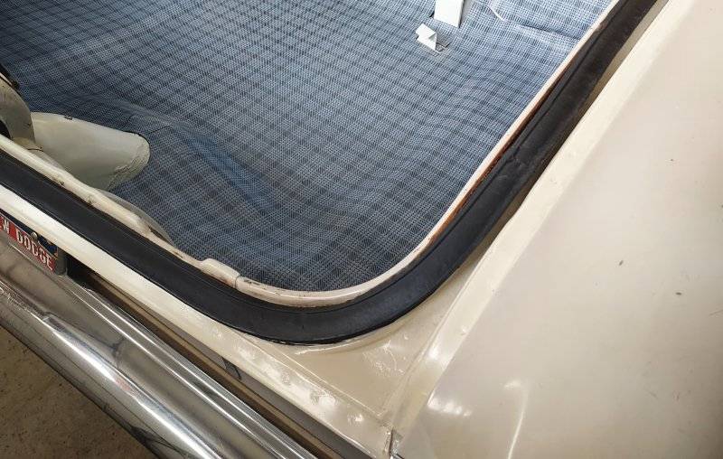

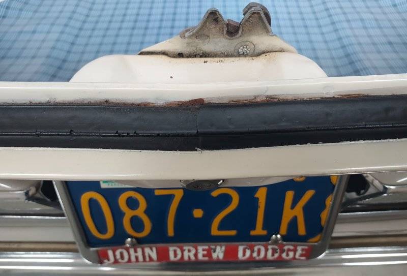

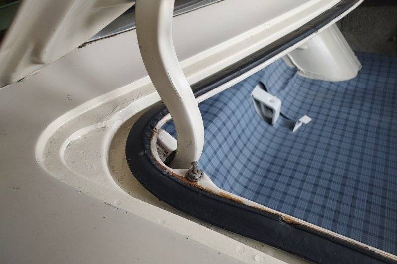

Can anyone share a picture of a properly installed trunk weatherstrip for an early B body? I need to know exactly where to glue it down. I remember that the ends butt up at the bottom. Thanks in advance. John
'62 should be the same as '63, no pinch weld. You can see the factory glue. This is still the original seal.
