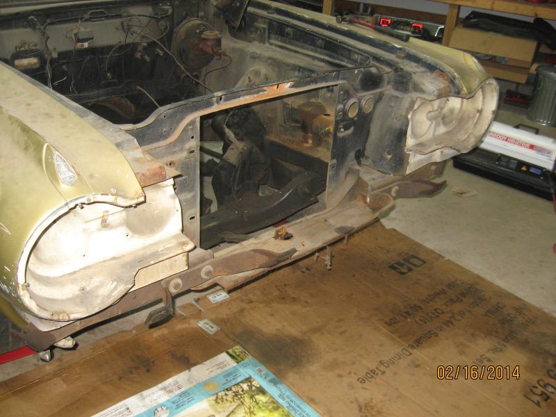

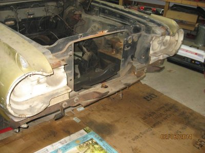

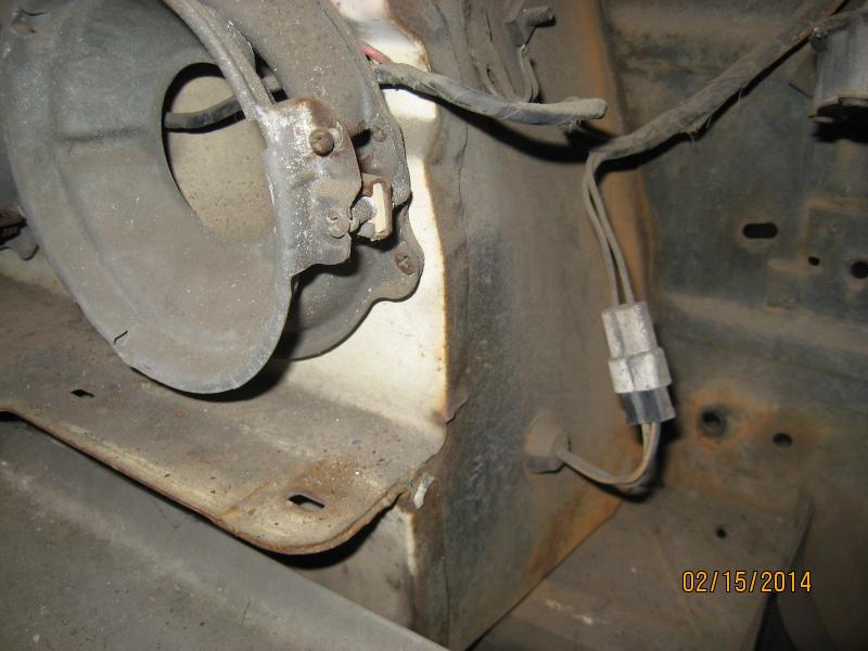

Hello again CPW,
For the turn signal wires, follow them until you get to the rubber grommets, then go past the grommet 6-8 inches and you'll find a flat connector. That's where you want to disconnect them. When you separate the turn signals from the bumper, those grommets stay attached to the turn signal wires. I'll try to post some pics here of my '64 front bumper area and maybe it will help.....
