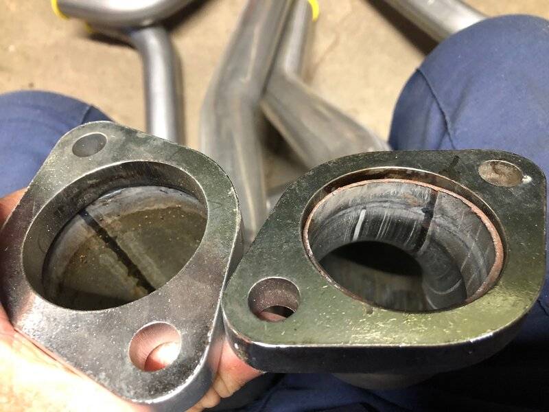

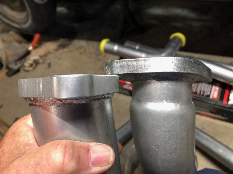

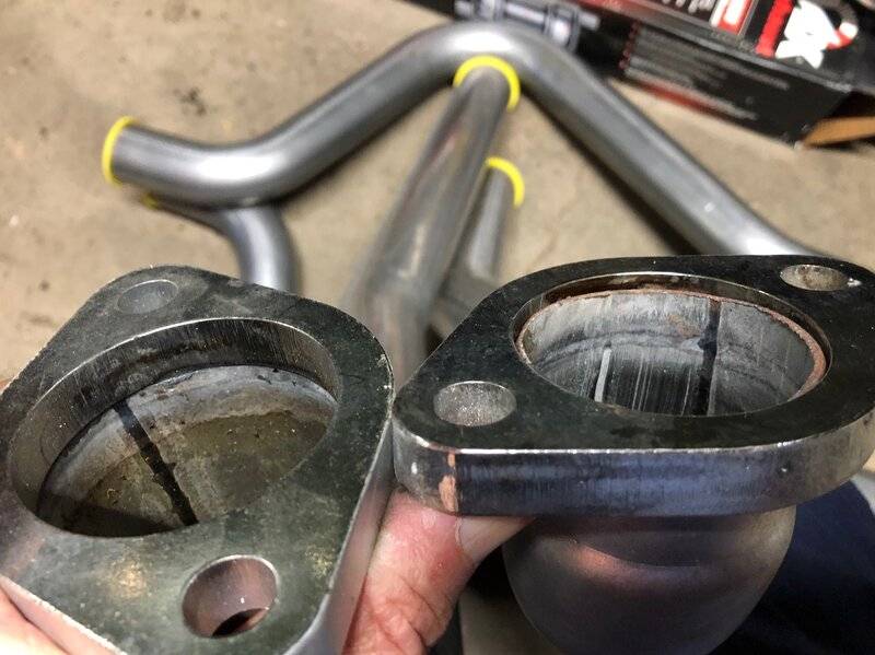

I just received my TTI exhaust for my 68 charger 383 automatic without headers. The down pipe on the drivers side is down sized and it's up inside the flange not butt welding like the passenger side. Is this the normal product for those who have this exhaust? Would this affect the flow compared to the passenger side? Attached pictures.

The driver side looks correct except the pipe should be welded on the inside of the flange, (think headers) with probably a tac or three on the outside. I've seen welds on the outside eventually crack.

I agree with 68moparmaniac the pipes should be welded on the inside (my 67 440 TTI pipes are welded on the inside ) every set of headers I ever made I welded on the inside.
The only reason for the smaller pipe would maybe be for bolt clearance .
From what I can see of the weld it may have been done in eight grade shop class.
Call TTI see what they say---- but I think you got screwed

I was wrong they were around $75.00 for both it looks like.
