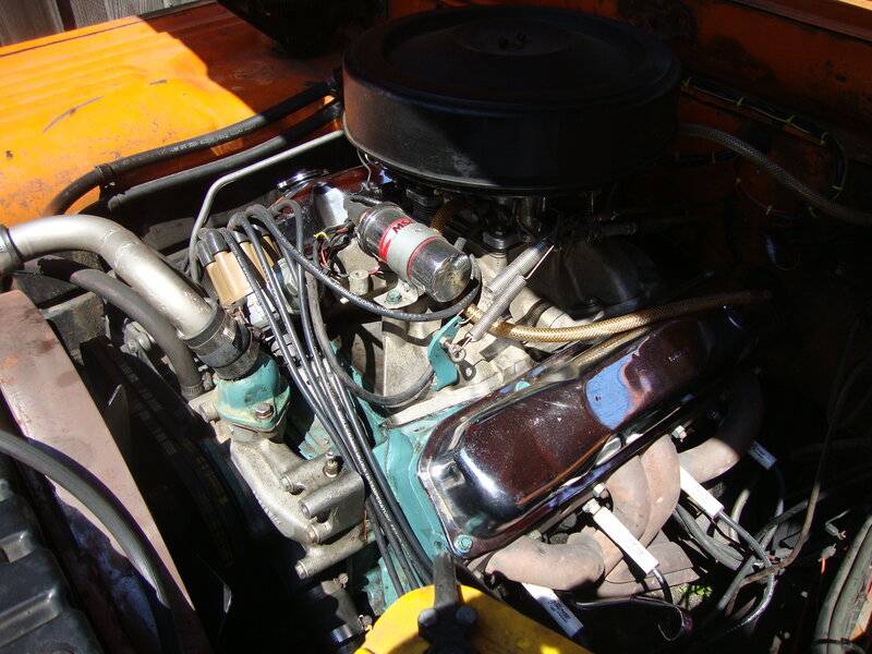

with an overlapping cam with alot of exhaust heat i went to ceramic ends . can't bend them , lol . they come in 45 or 90 as well . these are accel and taylor makes them also .

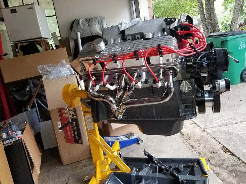

I just installed the Accel Ceramic wires on mine, now I dont have TTIs, I'm running Doug's 2". The 90 degrees all worked great except on #5 & 6, I had to route them outside and up.
Something I was not aware of when I bought the wires I assumed some kind of ceramic coating.... they are actually ceramic like a coffee cup. Have to be a little careful because I'm sure they would shatter if you dropped it.

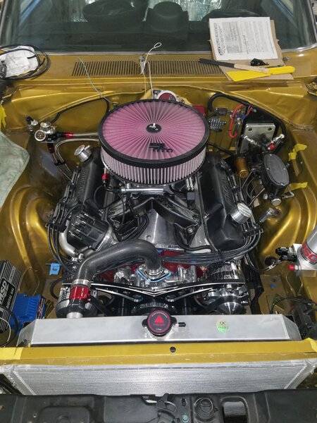

I used the MSD 135 degree ceramic wire set. I have TTI headers and sidewinder angle plug heads.
