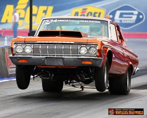

Offset Moog bushings will give you enough caster. Except for shocks and heims on the outer tie rod location, the front suspension of my 64 is stock. The K-frame is cut and lightened. Rubber bushings in the upper arms, poly bushings in the lower arms and strut rods. It's been 1.24 60ft, drives fine at 147+

If it already "transfers great", why fork with it?
They will help with the transfer if they have hiems. Mine did. In some cases you can transfer too fast though but, not an issue on my heffer of a car.
I had that problem with a car with ladder bars and 90/10 shocks. Well, the shocks were home made 90/10 lol. Ended up trying a set of 50/50's and it did much better which was surprising. Instead of pulling the fronts a foot and then landing and unloading the rear tires, it put the fronts up about 3" and carried them for a few feet and maintained traction. Good enough so I left the 50/50's in it. Man, I've had some strange combos on some of my cars but if it works, so what :D
If I loosen the shocks on mine it transfers way too quick and unloads. Usually the front rebound is between 75%-85% full tight. On a good track it can run 90%. This is with 54.5% of the weight on the nose.
Doug
Doug
54.5....not bad at all! The ones I hate working on are the ones with well more than 50 on the front end.
Doug
What torsion bars are you running and what type of front shocks
