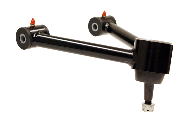

I have installed some QA-1s on my Charger but not near drivable yet. No heim joints just the same stock type bushings and ball joint. They say they are stronger than stock. The main reason I went with them is that it was a lot easier to just install these than rebuild my old stock ones and re-install them.
