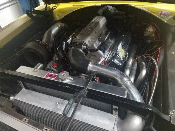

@Sweet5ltr Yeah me too. I'm gonna talk to my fab guy first to see what would be involved with modifying the exhaust to work with a low deck. Everything is pretty tight under there so moving things around could be pretty involved and honestly they just finished the exhaust work so I'd hate to redo a lot of it in such a short period.
Deck height is the only difference physcally, about 3/4", not huge though. Headers should work, same heads , cross over would probably have to be shortened
Thanks for the answer though, got any pics of your progress?

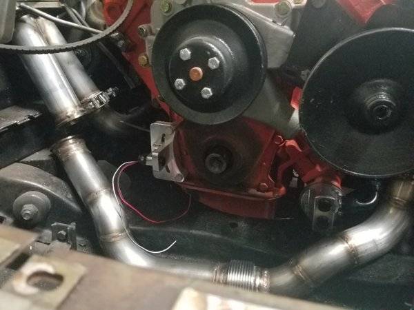

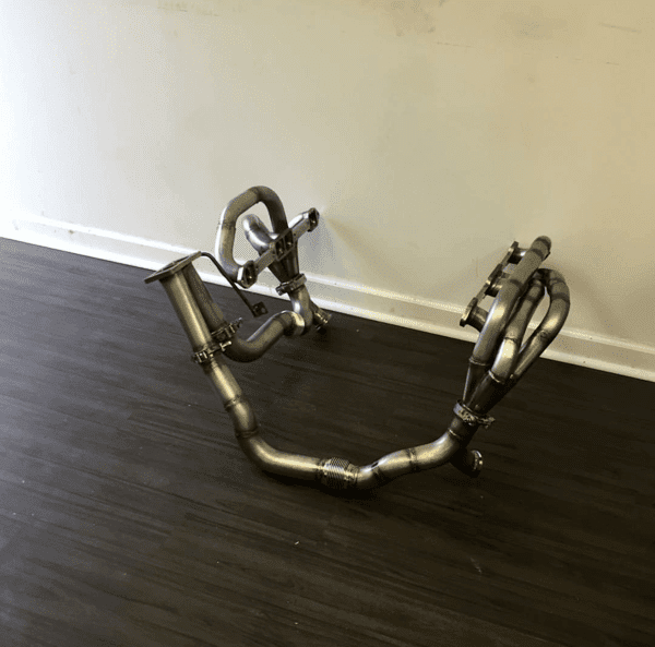

I don't have any decent pictures of the final product in the car, in running condition. The picture in the original post is probably the most complete picture I have of it. These pictures are of how the hotside looks outside of the car and how the crossover is run. With the cross over being right above the k-member I think that section would have to be re-done if everything moved down 3/4in due to it bottoming out on the k-member on both the driver's and passenger's sides.

Nice ! I wouldn't think everything would have to move 3/4 as that is based on 90 deg to centerline of the crank, and the angle would probably make it more like 3/8" lower but the width would shrink probably 1".
But I see why you wouldn't want to do it, definitely would be a pita to start over and retro fitting everything. Very cool project, have you started a build thread?
