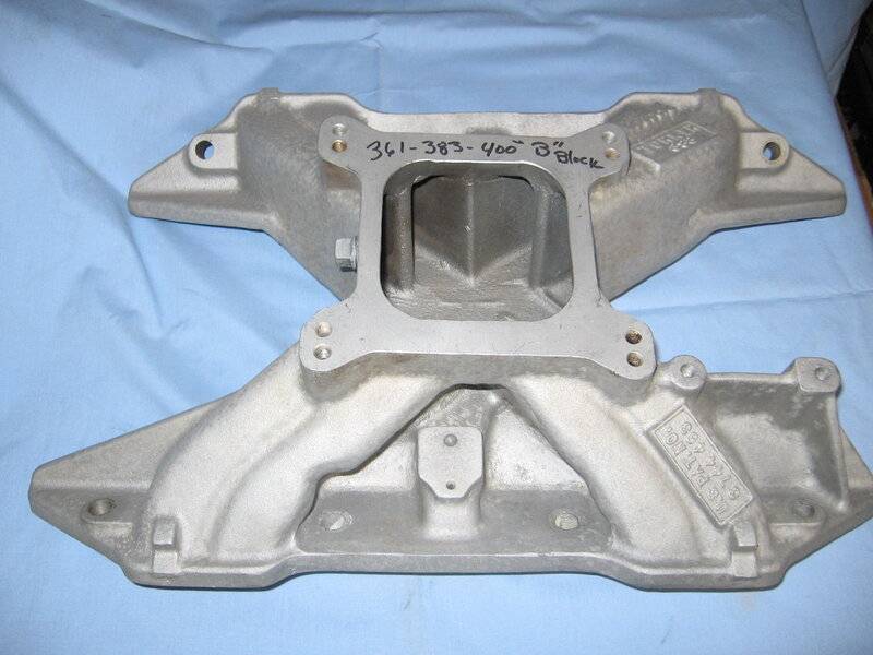

I have limited experience with low-decks, but I know the Holley street dominator is considered a very good manifold, and it is quite short.
The tm6 tarantula is the original version of the 383 torker, and if it's like the 440 versions, the tm6 has the same carb height, but taller (larger) ports, and would likely flow quite a bit more, in a boosted application.
I'm pretty sure the sd,torker, and tm6 are all out of production, available used only.
383 torkers used go for about a $100 at the swap meets.I had no problem with hood clearance on my 64 Belvedere.

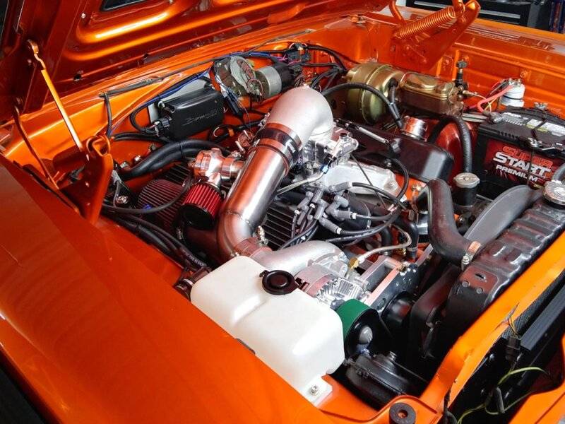

Little late to the party but on my 66 Satellite with the stock flat hood, I cleared by about 3/16'' with the edelbrock torker 383 manifold, holley super sniper 1250 (bit taller than a holley carb), and a blow through 4150 hat off ebay, on my supercharged 383.
