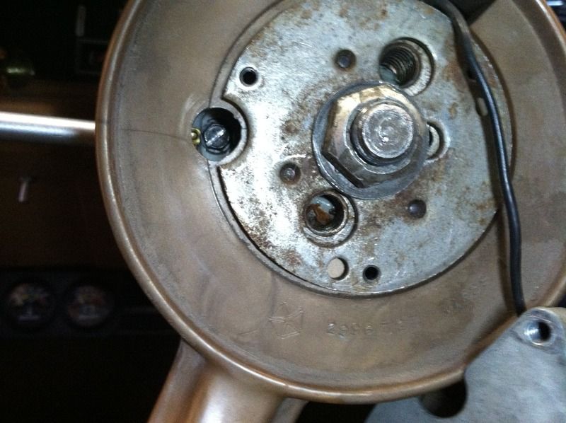

it started as having to manually turn the indicator off after a turn. something must've broke internally (assuming the cancelling cam), but the stalk is no longer attached. Question is do I just order the cam; or do I need a new stalk?
Take it apart first then see what you need.
Lucky fix...it was just loose, tightened the screw behind the horn button.
