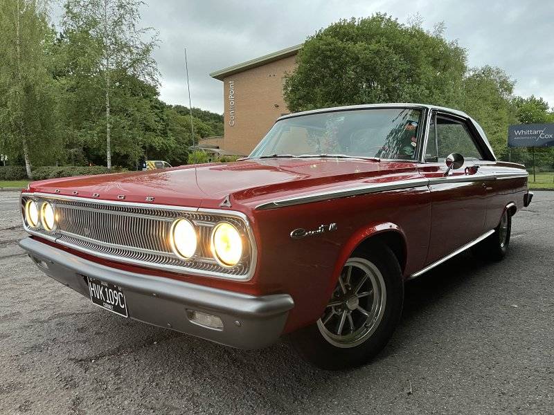

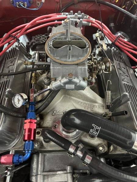

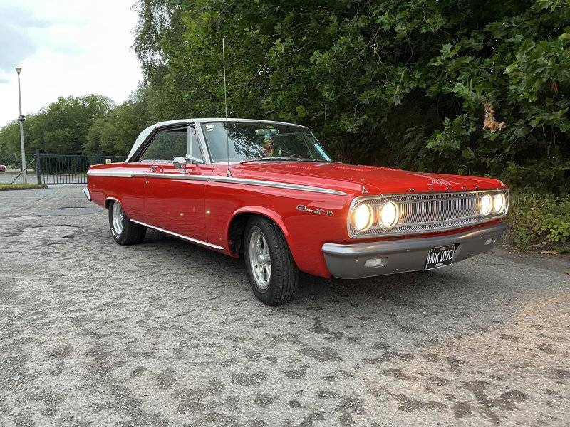

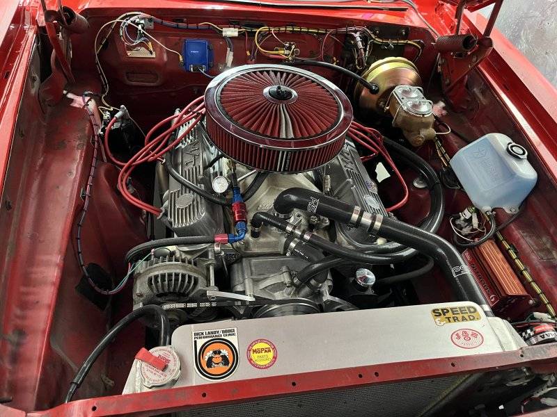

Hi all,
I’m the recent proud owner of a 1965 two door coronet. It looks to have been well looked after and has loads of upgrades in its time.
It’s a 440 car, but it’s fitted with a small block bored 318 (326ci) with balanced bottom end, edelbrock performer heads, Keith black pistons, Holley 670cfm street avenger carb, comp cam and lifters, cLevite bearings, cloyes timing gear, Mallory ignition, and ceramic headers. It’s bolted up to a 727 torqueflite, machined to take bolt in bearing, updated torque converter with B&M shift kick and kick-down kit.
It’s been fitted with some muffler bypass valves and sounds great. The issue is I just find the thing quite underwhelming in terms of straight line performance. I’m wondering if it’s down to the trans or rear differential? It’s only really comfortable sub-70mph on the motorway, so was considering a gear venders overdrive unit as well.
What are your thoughts? Should this sort of combo not disappoint or am I asking a lot? I’ve not driven a lot of American motors so don’t really have a benchmark. Also never drove this with a stock 318.
Assuming everything is ok, what might I want to consider upgrading for a better drive?
Many thanks all- pics for interest

Do you know which comp cam it has, or what pistons? Looks like it has stock manifolds on it? Gear ratio? Which converter?

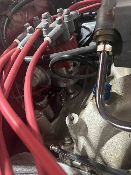

There could be power on the table if the ignition timing isn’t optimal and by tuning the secondary opening rate by swapping the spring, but it isn’t likely to set the world on fire. Ignition timing should be around 15-20 degrees at idle and 35 degrees total (without vacuum advance plugged in) at around 2500 rpm for best performance. You can probably also use the lightest secondary spring available.

That camshaft should be okay for that combination I think. What is your total ignition advance? At what RPM does your ignition advance not increase anymore? Then it might help to get a wideband O2 setup to dial in the carb, they make it quick and easy to get it dialed in.

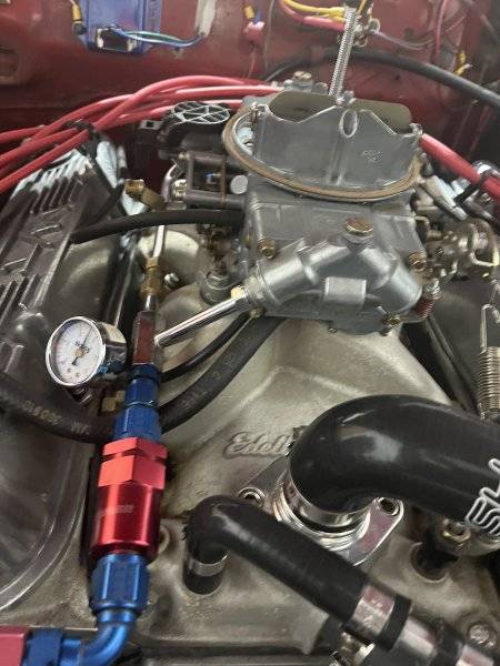

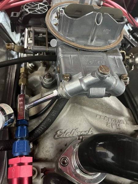

Is that a single plane intake manifold?
It’s an Edelbrock performer. Not sure otherwise?

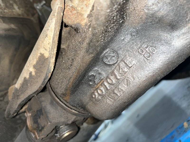

Is there a stamp on the case I could check? Or am I removing the diff cover?
Welcome to the site.
If you post a picture of the fender tag, someone could tell how the car was built originally. Especially the rear differential ratio. Most likely that wasn't changed. If it is slow from start, I would believe it might have a 2:94:1 gear ratio. Fairly common back in the day here.
Probably nothing on the case. Jack it up and spin the driveshaft and watch the wheels turn. Sure Grip carriers will spin both wheels in the same direction. Open carriers will spin the wheels in opposite directions. If so, block 1 wheel and count the revolutions. A mildly modified LA 318 with the right rear gear should make the car run pretty good unless you are expecting more performance then you should think about may be a stroker or a big block.
