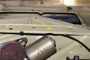

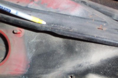

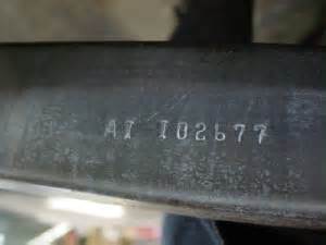

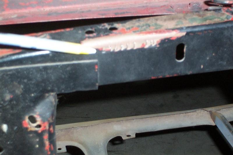

Here is the cowl and upper radiator support numbers on my 71. Should be the same on your 73.
On the cowl is it under the hood seal on the top plate that is welded on top of the cowl. Stupid place. 10 easy to get to spot welds and its off, or back on.

You misunderstood me. On the radiator support it is not on the top.It will be on the backside (the side toward the radiator) and on the drivers side.
On the cowl drivers side.Near the vent screen front right corner.If I remember right I had to pull up the hood to cowl seal.
rad.jpgcowl.jpgThis may help.
Also check the inside cowl above the heater box the vin is stamped there too.
