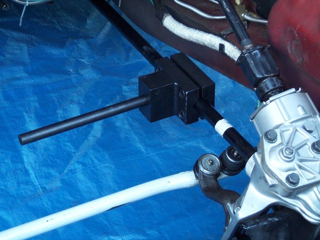

i was wondering how i go about unloading my torsion bars. i know they make a special tool for this but dont have 1. how all do you guys do it
Unloading is done with just with the 5/8" tensioner bolt that is under each control arm. Are you talking about actually removing them? There is a special tool for that-

Even with the adjusters loosened all the way (use an impact wrench for that, it's a lot faster), they were a biatch to get out using the special tool. (yes, I removed the clips first) :grin:
First one was a pain. Second one, I removed the shock and took out the UCA (since I was replacing the stock ones with the Firm Feel ones) and completely unloaded the t-bar. It was a lot easier at that point.

After taking the clips off I loosen the nut on the lower control almost all the way off and then tap the nut with a hammer. Then put a flat ply bar between the lower control and k member and the torsion slides out. I took off five or six sets this way. Works everytime.
