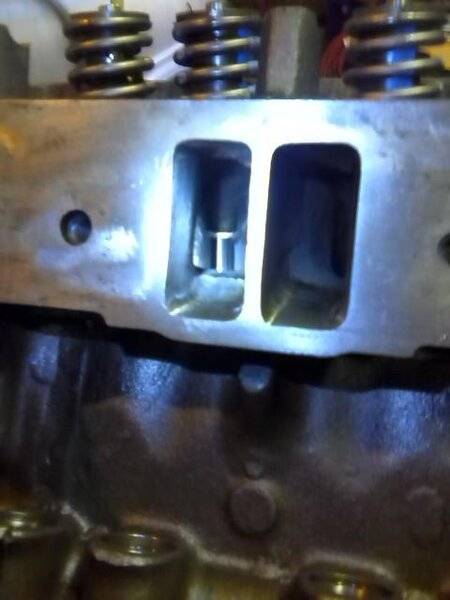

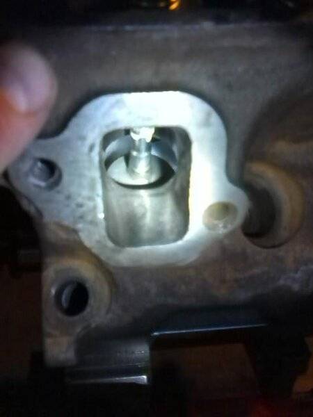

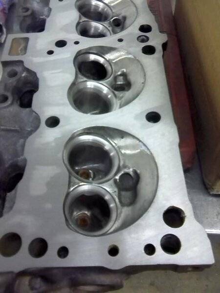

Nothing wrong with the 273/318 heads. They can be made to work.

Valve train issues being swapping to the stud rockers, different pushrods and lifters. Mags oil through the pushrods like chebby. I stand corrected on the valve size issue.
You need AMC lifters (that oil through the pushrods. Most hydraulics nowdays do) and hollow pushrods to get the oil to the rockers.
