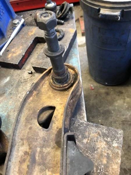

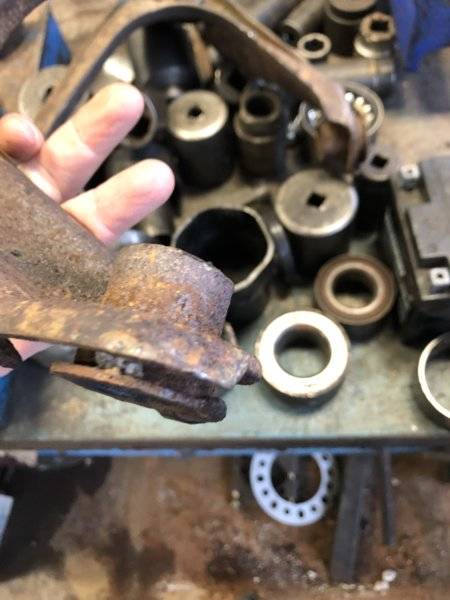

I just dropped my front suspension to replace everything. My questions are, what should the upper control arm look like after the bushings are pressed out? Mine look like they have a sleeve, it’s hard to tell because everything is rusty.
My question about the lower control arms is how does the shaft come out? Is there a special tool or technique?

The lower control arm pin/shaft gets pressed out from the end that the torsion bar fits into. I have a machine shop do all of my press in/out work. They also leave the UCAs, LCAs in their solvent tank to clean them first. It is a nice gesture.
Your parts look normal to me.

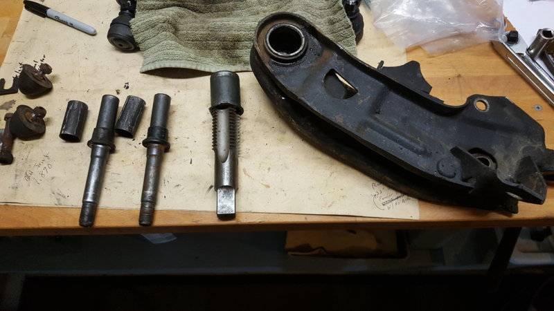

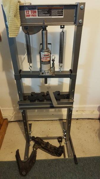

I got me a $100 press from Harbor Freight and a 1-3/8" tap off ebay for $13. It was a piece of cake. Then all you need to get the bushing off the pivot pin is a chisel and a vise.

Yes that upper arm sleeve/sleeves needs to come out. Reference your new bushings for example.
