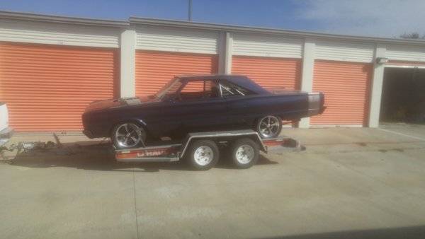

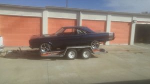

any chance you can post some pics?

This is the only one i have on my PC. Ther is another one on my build thread but the car is on stands so you cant really get an idea of stance.
