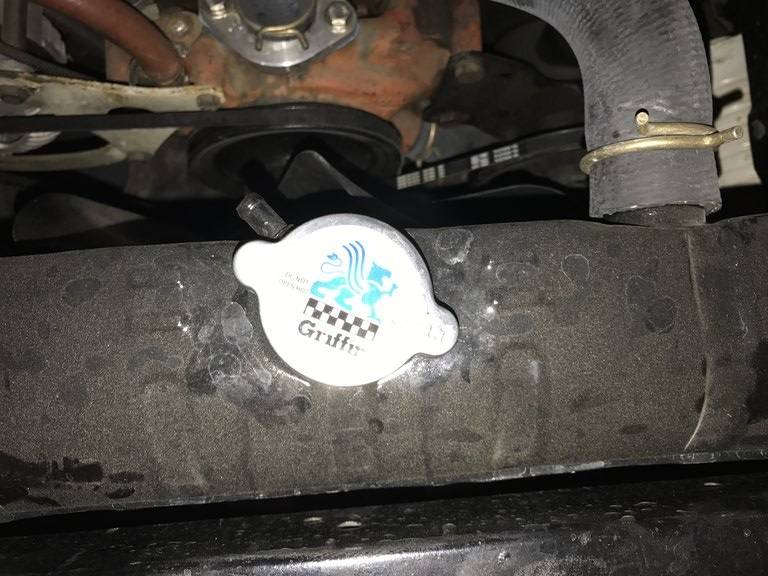

Thanks Don A for coming on and commenting. I bought a 22" four row from Yearone, thank god I did, I would've been screwed. They asked If I would call US Radiator, no problem I said. The guy that took my call at US Radiator was not professional at all. I called within the 90 day warranty period with the cracked tank, leaking problem and the overflow tube out of place (pointing to the back of the engine). The customer service guy made an excuse saying it happens and said US Radiator would fix it, but I would need to pay shipping both ways. I called Yearone back and explained the experience I had calling US Radiator. The guy apologized and asked if I would call US Radiator again, I said yes. I called US Radiator again and spoke to the same guy (he doesn't speak English too well). He was more rude this time and asked if it was within the 90 warranty period. I told the guy the warranty expired three days ago, he laughed and said sorry US Radiator could not help. I called Yearone back and their professional customer service told me to have the radiator fix locally. I did, paid over $200 and Yearone gave me store credit. I understand that quality isn't what it used to be, but customer service should be top notch.
View attachment 496895 View attachment 496896
Thanks for your comments John. We've already had a meeting and discussion on this issue this morning with the folks involved and will have another before the end of day to better address your problem. While our warranties are fairly specific to the radiator itself however, all things are negotiable, and a better solution to the freight issue or a replacement would have been my suggestion at the time. Also, hiding behind a one day past warrantee is not who we are either. Call me if you would like a better resolution at this point. Don
