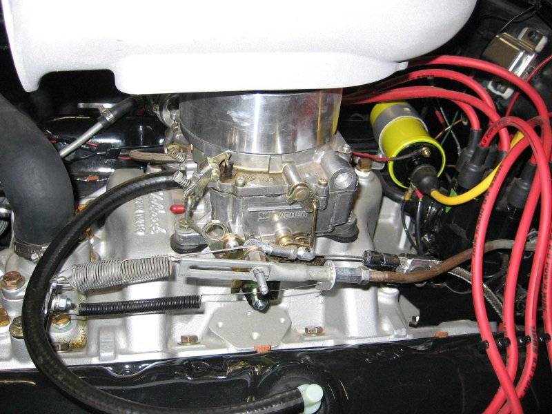

I would rather not use the Lokar-style kick down setup. I prefer to re-use the factory 318 kick down linkage because I just like the way its setup (photo #1).
I transferred all the '72 318 linkage to '72/'73 340 intake manifold and that is fine. However, the Thermoquad doesn't exactly match the Carter BBD .So for this week, I made an adaptor for the Carter to fit on the 340 manifold just for fun to see how it runs and shifts (initial start-up coming soon).

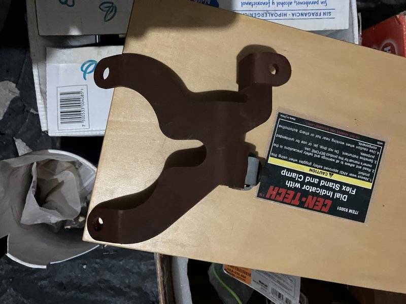

I did purchase some kind of bracket (see photo #2) that is supposed to be for a 340 but looking at it I can't even figure out how the 340 used it, let alone how I can use it or adapt it for my purpose.

As long as the Throttle Valve linkage on both the transmission and carburetor reach WOT at the same point, I don't see a problem. I've cobbled together linkage for many 4 barrel conversions. Heck...I don't even know what a correct 4 barrel linkage looks like.
I have never burned up a transmission from misadjusted linkage.
Back in the 80's & 90's, maybe even early 2000's finding complete small block 4bbl Aspens & Volare's was pretty easy, they used a variation of the three piece style kick down linkage....
I used those parts on dozens of cars that I converted to 4bbl manifolds...
Most other body styles with a small block & a 4bbl used the one piece style linkage which doesn't fit as well or work as consistently...
These days parts are harder to find so if I were doing a conversion I would use the 2bbl parts but my welder & grinder would be getting more experience...
From the intake down to the transmission KD lever, I figure that the setups are the same. Up top, I've extended the linkage rods, modified the mounting brackets and just made stuff work.
On a 4 bbl carb [ TQ ], the primary throttle shaft is probably going to be further forward than with a 2 bbl carb. T/cable & k/down connect to this shaft. I am not sure how Chrys handled this difference, but it could have been with a different t/cable & k/down parts/levers.
The intermediate rod (from bell crank to bell crank) is about 1/2" longer on a 4bbl set-up due to the taller manifold... That's where that redesigned throttle cable/KD bracket comes in, it cheats the position of the KD pivot to find a spot where the shorter rod can work.... It's better to lengthen the intermediate rod...
Since I have seen so few actual 4 barrel LA series linkages, I've just modified stuff to fit and work. Maybe I've just been lucky?
There's a 727 trans lever and a 904 trans lever... There are assorted bell cranks with different ratios & angles but generally if you keep the original lever & bell cranks the ratio will work.. The sweep at the carb stud originally remains consistent whether 2bbl or 4bbl... Where the issue comes from is guys bolting a stud onto the throttle lever in whatever hole they can adapt to.. Holley & Carter both sell add on levers with the proper Mopar lever ratio..

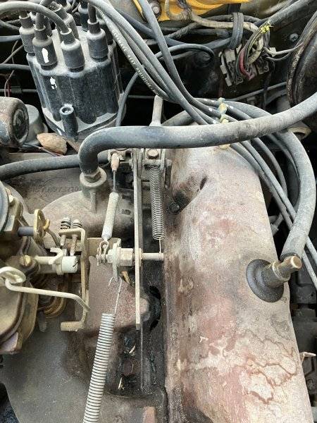

Just a few photos of small block 2 bbl linkage hooked to 4 bbl
Yeah, the second photo, I'm not proud of the throttle cable but sometimes you use what ya got.
Crappy aftermarket but it works.
The manifold bracket is 2 bbl. Just needed a little bending for alignment. Hardware store threaded long nut and all is good.On both cars.
