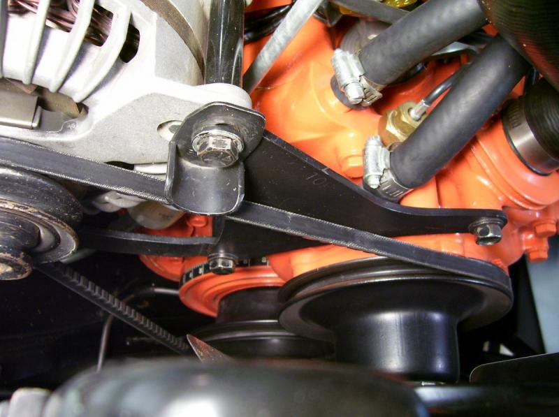

the cure.
I was only bustin about the 1/2 hp, it looks like a great idea. Hell of a lot easier setting tension on that than yanking on the alternator.
the contraption sits above the belt. the belt only contacts the thing when it gets distorted at high rpm.
I have had cheap belt come off.
Put good gate's belt's on and no more prob.
Have a friend who also had this problem. 73 RR 400 with A/C and PS we did the aliment and checked all the brackets. Had all original bracket hardware and pulleys, we tried different belts with the same end results. Would throw the power stearing belt on deceleration and always from the water pump pulley. If this is your case check the pulley groove a make sure it has not been bent, a change in belt groove width create slack in the belt every rotation of the pulley causing the belt to bounce. Acceleration and deceleration compounds the situation causing the belt to jump the pulley. And yes then the belt stretches braking the cords in the belt and it becomes junk. Belts can also come off due to different loads on the belt at different locations and a similar bracket as shown above was used by GM to solve the problem. And that is GM engineering.
