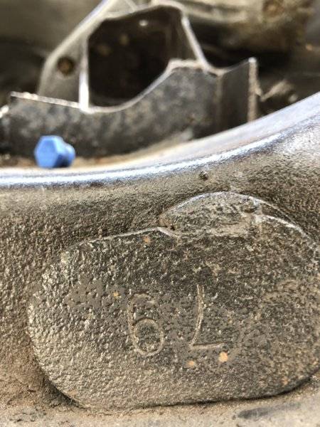

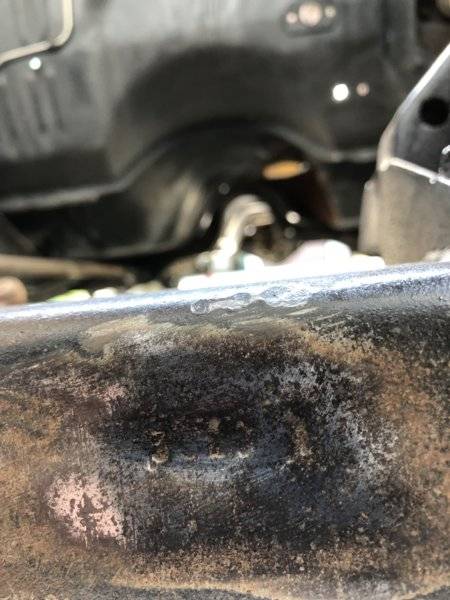

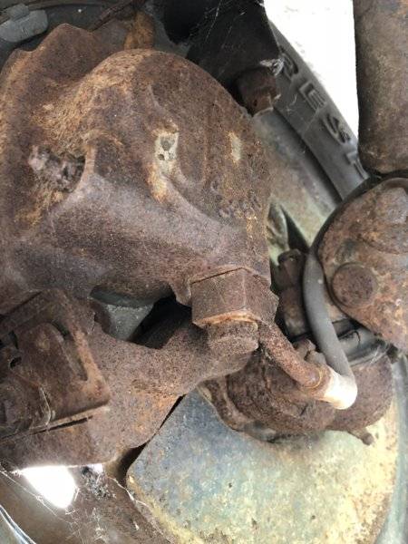

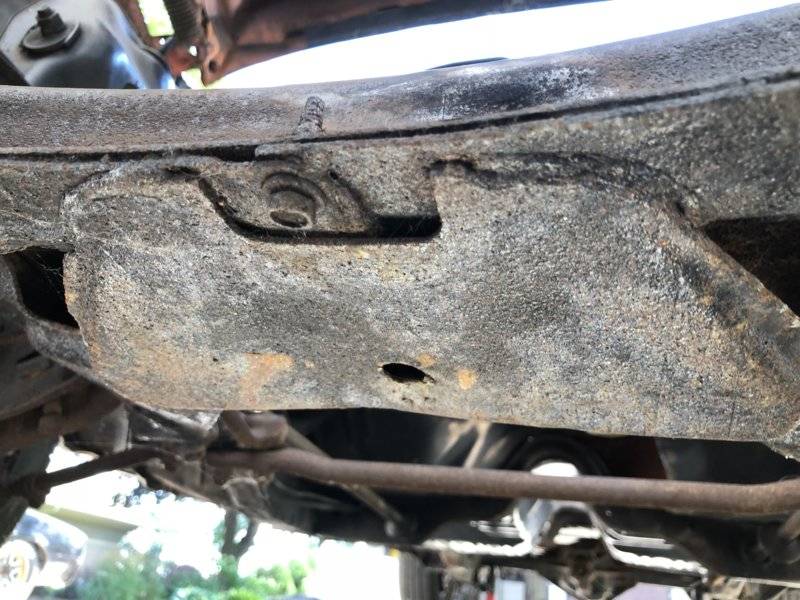

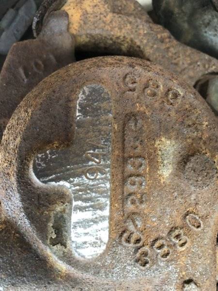

Thanks for the reply you are correct, those terms are thrown around loosely. When I take on a project I always try to find NOS parts. If you look long enough and pay good money you can usually find them especially on main Item such as drive-line, wheels, trim, and engine components. In this case I am looking for it to be correct.. Thank you for the link to those calipers. Here are some pics of current calipers and of K member that I have I'm sorry that is the best I could get the center number.
The k frame is correct for your car. The 79 is the last two digits of the part number. 1970 440 B body with skid plate. The calipers are not correct. They are later slider type, used on A bodies among others.

The calipers as others stated are not correct.....Below is a good example also...
http://www.dodgecharger.com/forum/index.php?topic=111631.0
