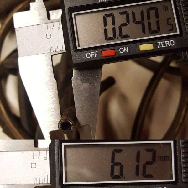

what is the vacuum hose size/diameter for the heater control switch? Thanks in advance.
This much.
I wasn't able to source anything the right size locally for that so I wound up using chainsaw fuel line. It seems to be working ok.
