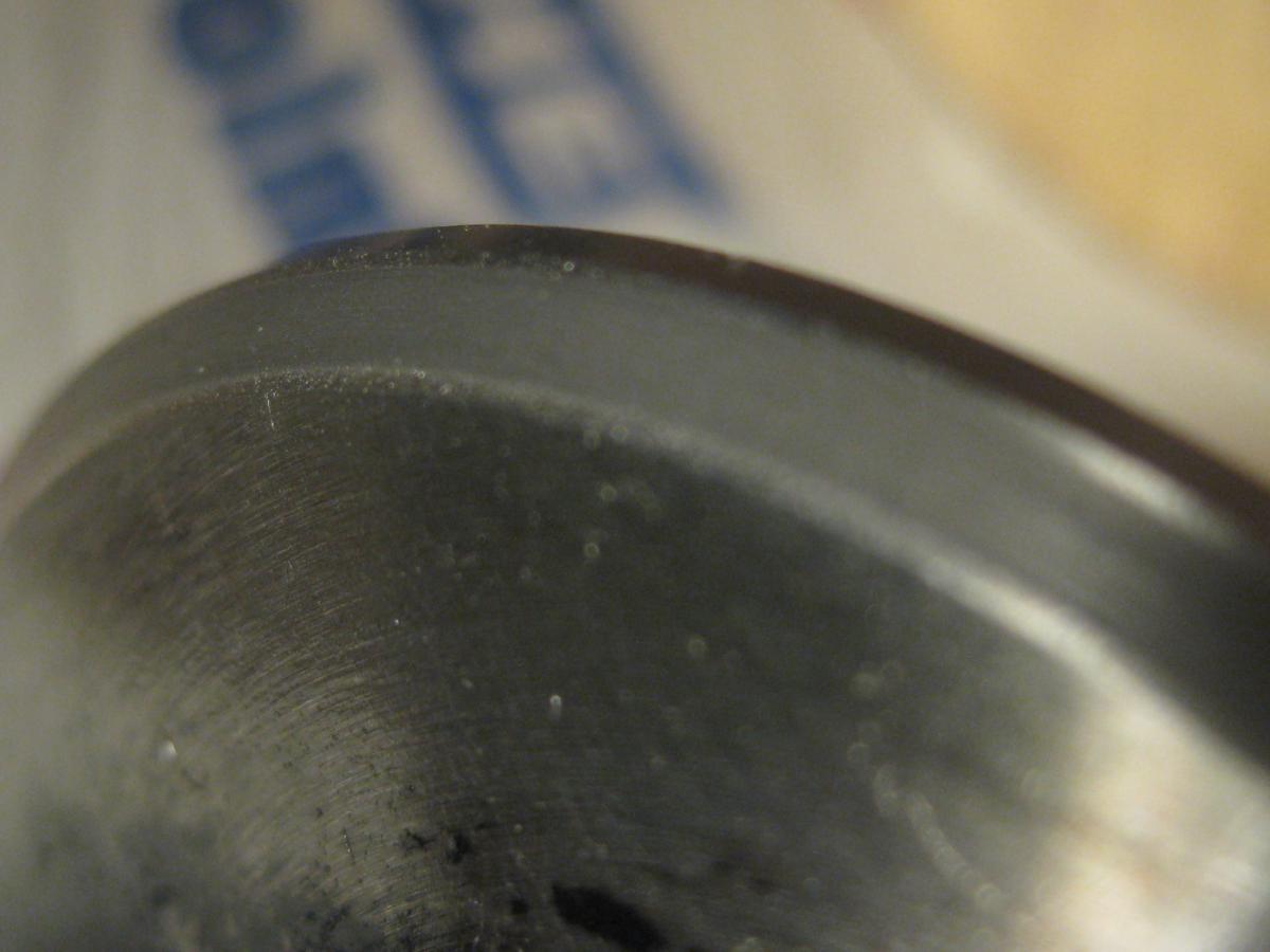

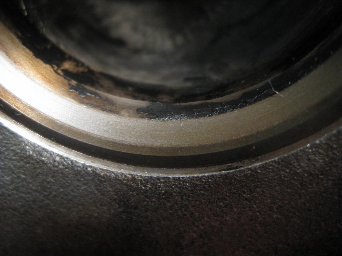

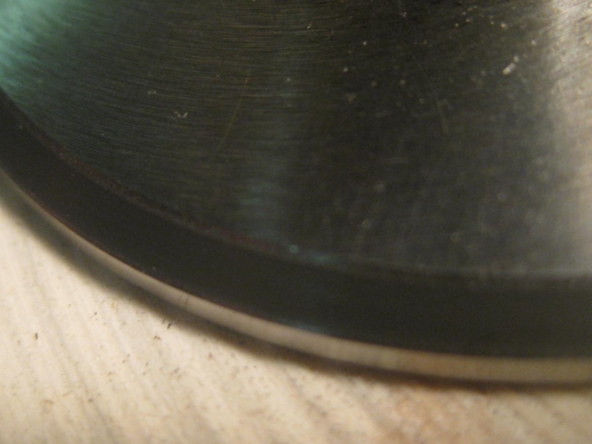

I just finished one of the heads. Unfortunatelly I didn't buy 2 stage compound. I usd permatex from a toothpaste style tube. The contact area didnt look bright like I was expecting but rather a dull gray. The finish actually looked better before I started. Should I try to find better compound or is this normal?

Andrew, best i can tell from the photos you should be ok. I will add, that I only lap valves on used pieces if I have the heads apart for some reason (springs, porting etc). But with fresh parts from the shop Its not required.

Yep, dull gray and smooth is normal. Looks good. What's more important is the seat width and position on the valve as that's the primary path for heat transfer out of the valve head. Looks like you have some good margin too.
