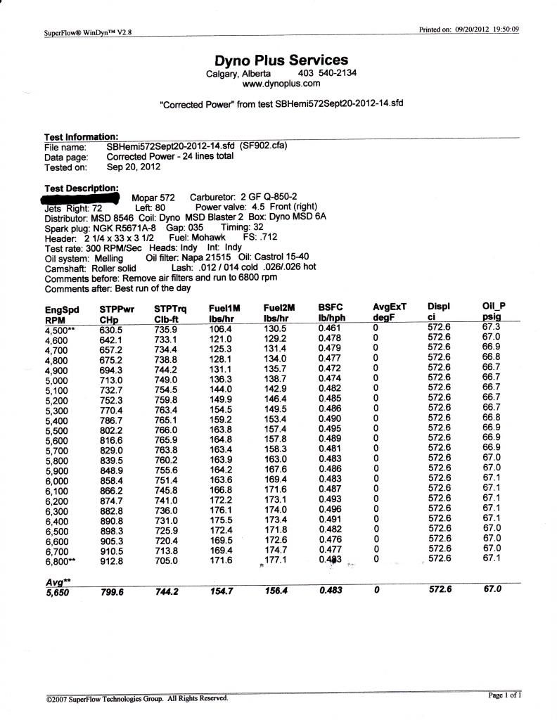

In this day and age, and for many, many years, we(my Shop, I OWN IT) have been able to exceed 900 HP and 765 Ft/Lbs Lbs Torque on a 572 HEMI using:
* 91 Octane Pump Gas
* .640" Intake and .617" Exhaust NET Valve Lift, sub 285* @ .050 Roller Cam
* Good for 6,000 miles street driving with NO ISSUES (we just freshened it after 5 years, and bumped it up past 940hp)
Does the above in some way illustrate to you from my world the WHY I was ASKING:
* What benefit are YOU expecting going from 285* @ .050 with .736" Lift.... to a 296* @ .050 Cam with .785" Lift ? and what do your Heads Flow ?
