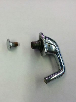

Hello,
I wonder how the small handle (latch) is attached to the front vent window.
Mine that fell on the road, luckily I found it. Scratched, but I found it.
thank you
Yup, You can probably buy that small roll pin at your local hardware store. Just make sure that the new one fits tight.
Good Evening,
The handle has a small pin that is pushed in place and attaches in a small groove. If the handle fell off, you probably lost the small pin.
Regards,
The small pin still on place, but only the bolt fall off.

You need to drive the pin out, take the handle off and put it back on the glass.
