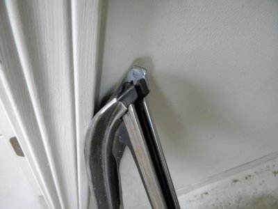

got it apart. found bottom gaskets from kramer but i need the rubber tip that gos on very top where the screw holds the frame together for hard tops only sedans or conv. won't work
vent window
I have a passenger side frame from a 64 polara , still has the top piece. Is this it ?
