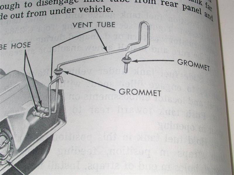

After being apart for much work, put 15 gal in last night, and had a small "drip" from the vent in the front of the tank (short hose, connected to long internal tube per manual)
Not overly warm here (70 ish), and tank was only slightly over 3/4 full
I had the same issue before disassembling the car, long and short vent lines were blown clear with air, tank has been replaced (spectra premium ?) and the vent lines inside are actually incorrectly routed (per others photos and experience)
I made sure short vent hose connects to long internal tank vent tube, and that long vent tube into trunk is connected to short internal tank tube

I'm not certain which way they are oriented currently (I can look again tonight), but I do know that I have the short external vent tube connected to the longer internal tube that reaches to the rear of the tank and the longer vent tube into the trunk connected to the shorter internal tank vent (near the front of the inside of the tank)
This is because I am pretty sure the current aftermarket tanks do not always have the original vent tube orientation, although they do have the long and short internal vet tubes, pinched at the ends slightly inside the tank
I'm not sure the vented cap will work, but don't want to modify the existing cap unless I'm sure it won't create more of a leak !
Something isn't right. I just installed a new tank and have no issues, you are correct in that the long internal tube connects to the short vent line that attaches by the shock tower and the short internal tube connects to the long vent line going into the trunk. If the vent lines are open, you should not be having this problem. If you are sure they are connected right, try blowing air through them

If you have the repop tank with the vent lines reversed on the inside you can just swap the hookup on the outside. The cap isn't going to make a difference.
Vent cap will leak like hell from fuel slosh. Previous owner had one on the car when I bought it, leaked a few gallons of fuel on the flatbed home.
I do have the hoses swapped on the outside of the tank
Long outside goes to short inside, and short outside connects to long inside
