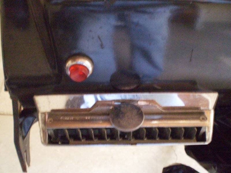

I am posting a list of parts I used for installing a Vintage Air system in my 1964 Polara. The car previously had a factory A/C system in it, so I already had the appropriate pullies, brackets, and dash vents. Perhaps the Mods can make a "sticky" of this post.

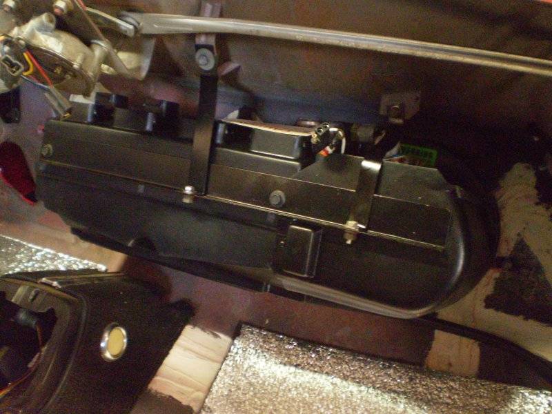

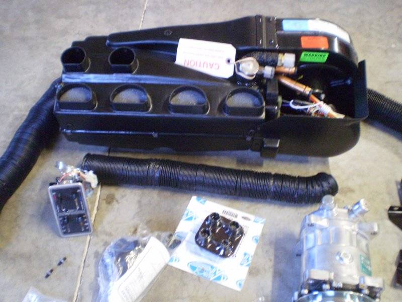

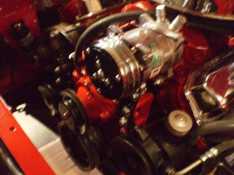

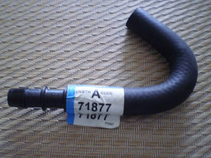

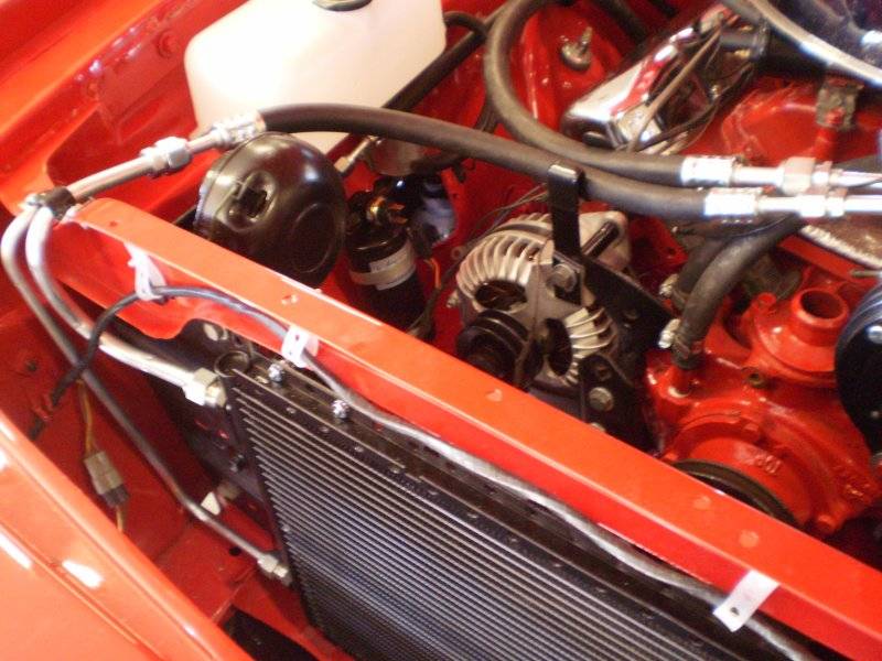

Maybe you could post some pics of the install and finished product?

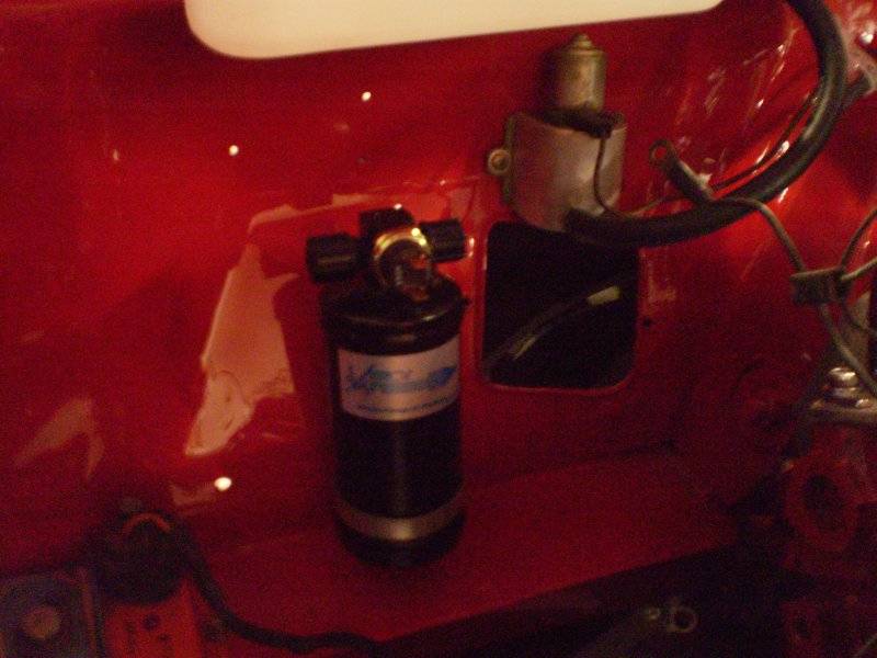

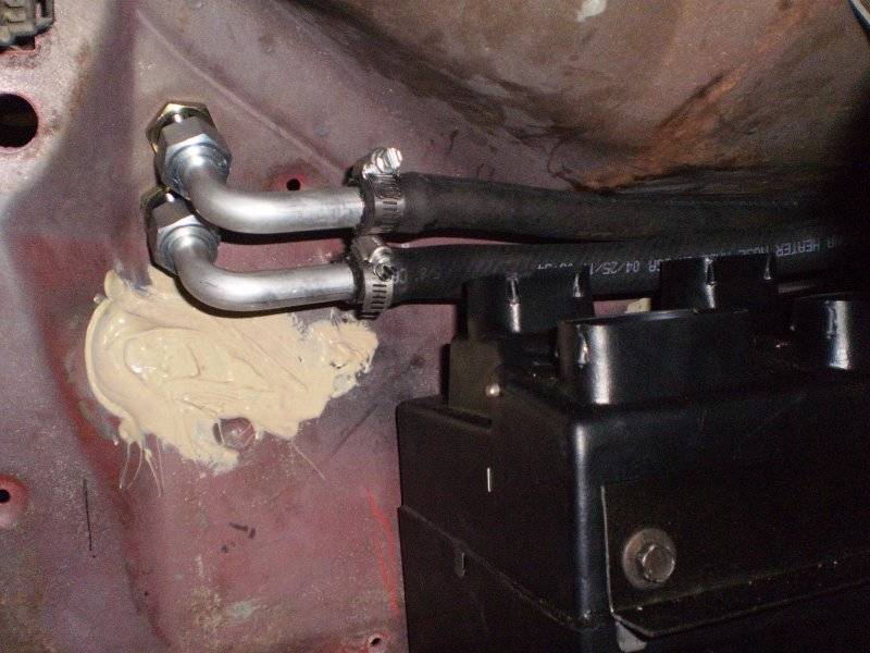

More. Brackets for A/C lines on passenger side of engine compartment are 1966-1967 heater hose brackets.
