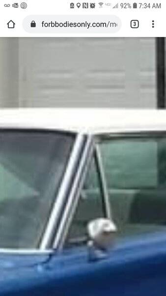

i'm going to ad a vinyl top to a 67 coronet RT. I'm looking for a couple of gd pictures of where to terminate the vinyl on the A pillars and how it was done. Measurements to if possible on the pillar. Was there any terminating chrome or stainless on A pillar?
dan

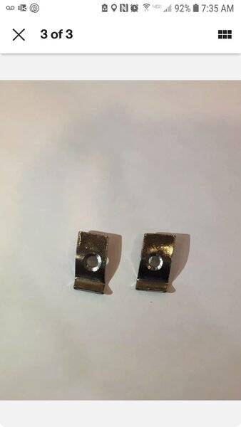

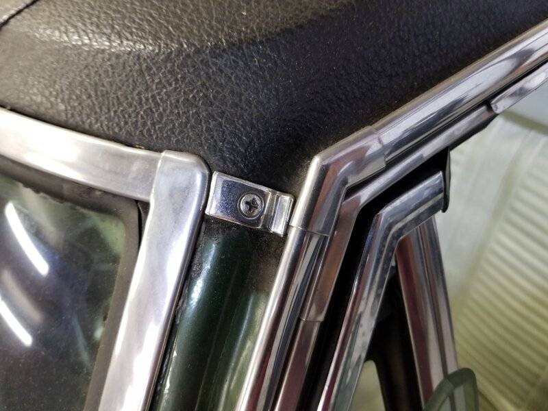

It lines up with the top of the windshield molding. Yes there are two small chrome pieces that finish it off

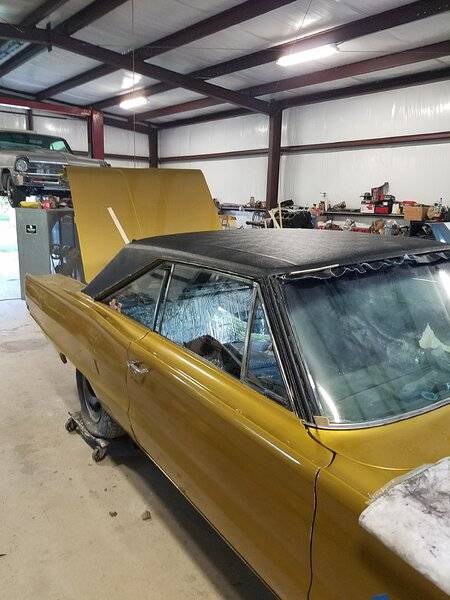

My car was not factory vinyl top. The top came with material that ran down the A pillars. I completed it under the lower windshield trim.
I’ll bet those little chrome piece’s are going to be tough to find
I did the same, when painting my car I thought it came that way....lol!
I did the same..... looks like the same seller has a ton of them.:D
They are not oe. I won’t be able to use them as delivered. I think they need chrome plating and a little love to pass as oe.
