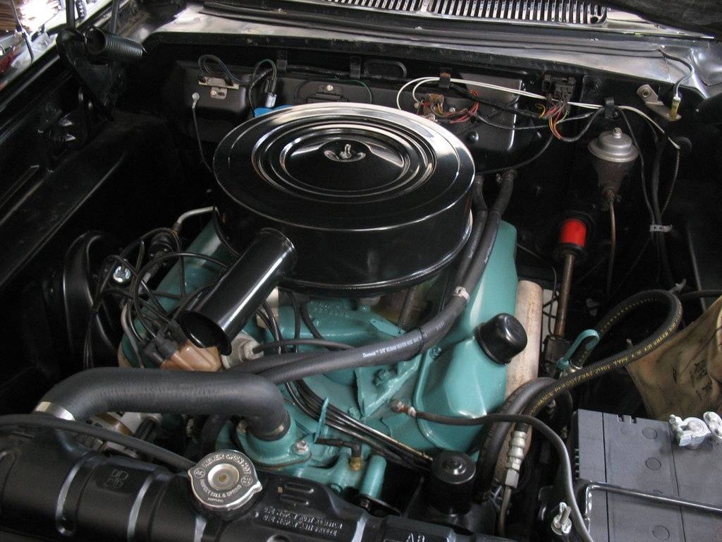

Fresh engine new everything under the hood. Amp works fine the temp and gas are the ones not working.
