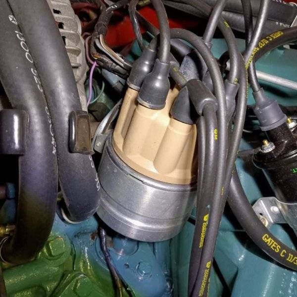

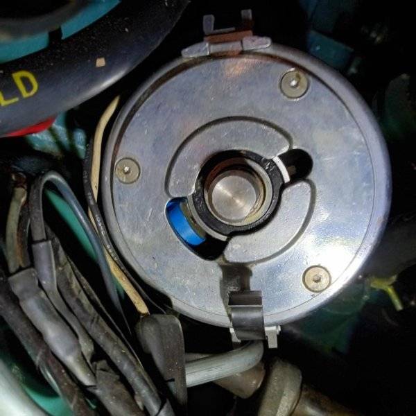

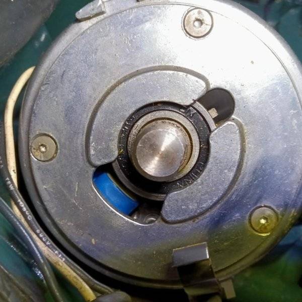

A PO had installed this as well as the purple cam but other than that not sure what if any benefit the blue regulator gives me. I do have an unknown distributor with no markings I can find with electrical ignition, so no points. As I have the unknown distributor perhaps it needs to be run with the blue regulator to run the system properly?

Regulator is a fixed voltage style. Not recommended for street use. That distributor is unique with the bearing at the top of the shaft like that. Cant say I have ever seen one. Is there any tags? vacuum can?
No tags, no vacuum can. There is some writing on the black plastic, from what I can see it says China (shocking). Based on my knowledge of my car it was probably done in the 80's perhaps very early 90's.
