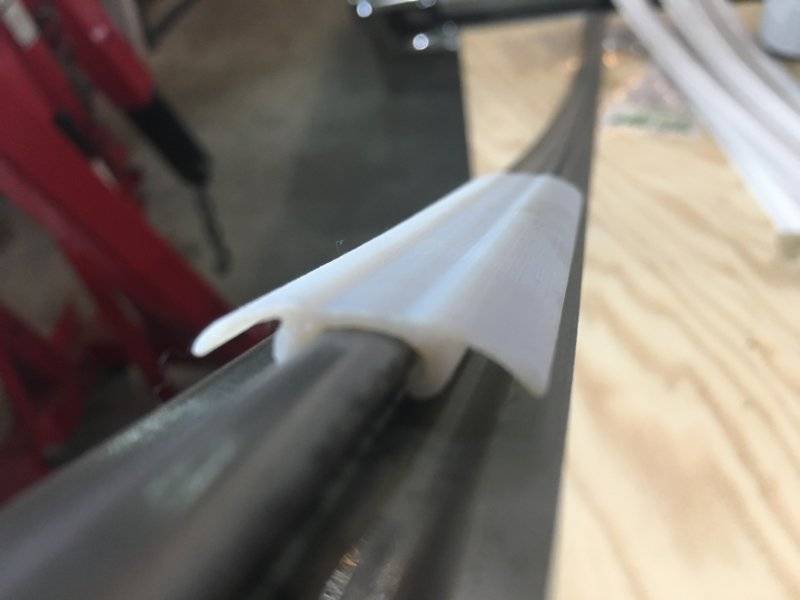

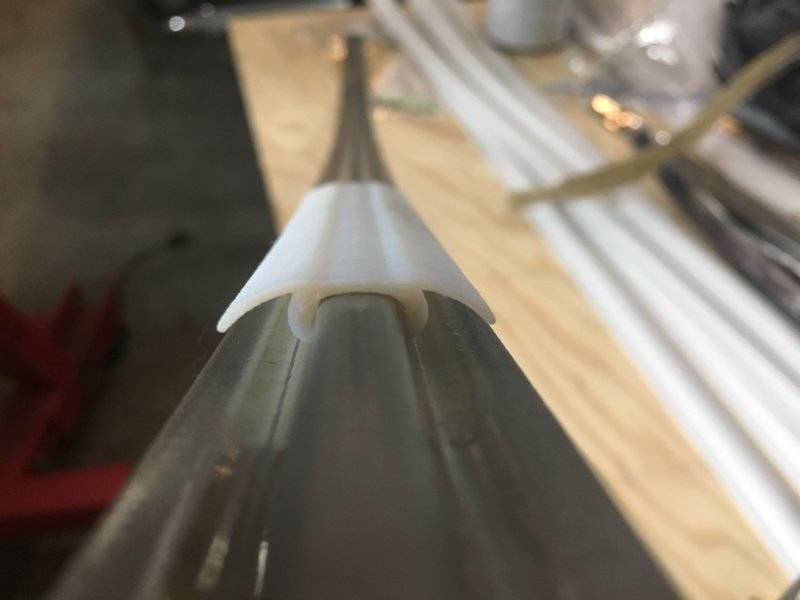

I'm curious to know if anyone out there with 68-70 Wagons are in need of the plastic trim pieces that snap onto the metal bows to hide the gaps between the hardboard liner? Here's some pics of the plastic trim I'm talking about.
I'm looking to have some new plastic trims made for my Wagon and if I knew if there were others out there interested in replacing their worn, faded, broken or missing pieces, I'd have extra made. I'm not sure of the price yet, but will post pricing once I get some feedback from those interested.
Just checked my 68 and 69 both are good if I do not touch them.... I'm sure they are brittle. That IS the correct profile.

What material will they be made of?
Hard plastic formed into the bow, or soft plastic that bends to conform?
I'm targeting a softer plastic that will bend easier and confirm to the roof shape.

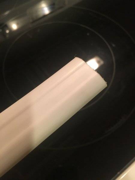

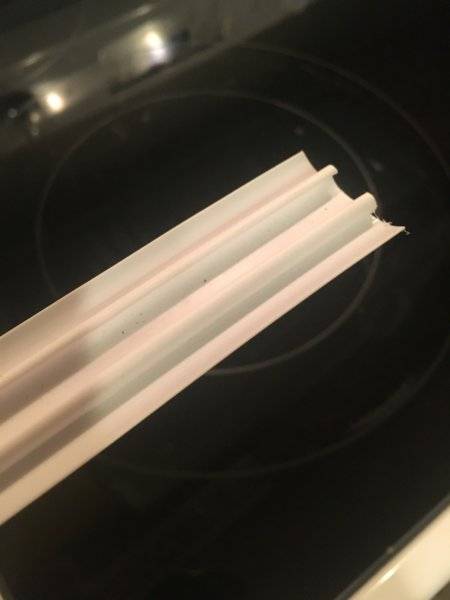

Well I finally received my initial samples today of the new plastic trim pieces.
I plan on installing them in my wagon this weekend to confirm fit and retention. Hopefully they work as intended.
I would be interested in hearing how everyone feels about the headliner fit and finish for your wagons. I have had some inquires and I spoke to REM as they are the supplier of them. They told me that the 66-67 B-Body was one style and that the 68-70 B-Body was a different part number. They know that they fit the Dodge applications, but he was not sure if that the Plymouth panels were the same.
