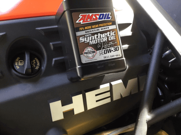

0-30 in both of my 5.7 Hemis. Amsoil Signature Synthetic. Ignore the 5-20 FCA recommendation. 20 too thin and 0 weight start up protection can't be beat. Annual change. WIX/Napa Gold Filter.
Do not ignore FCA recommendations if your Hemi has variable valve timing. The oil control valve used to direct pressure to the camshaft phaser is sensitive to viscosity changes. People have had their VVT fail because of this. If you use thicker oil and end up getting a P000B code on the OBD-II, you'll know what happened.
0 cold start flow. The 06 Charger has the shutdown and the 09 Challenger VVT. FCA recommendations all about emissions.
If FCA is all about emissions, what about their service bulletins? See TSB 09-015-04 and 09-013-04: “Vehicles with the Multiple Displacement System must use SAE 5W-20 oil. Failure to do so may result in improper operation of the MDS.”
OK. 5.7 purrs like a kitten. Quiet and good power. Want reliability and power. Not concerned with the MDS working.
Detectable MDS transition has remained the same since switching to the 0-30.
