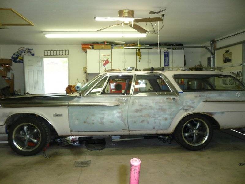

I would guess that the biggest downfall of the early 62 PB 727 is the fact of the 19 spline narrow converter bushing when being used in a performance application (there are almost no converter choices) ..But since you may have a core transmission (67 and up ) you could use the pump/stator unit from one of those and put it into the 62 PB 727...so you could use a better performance converter. There are better people to ask, like Dave6T4 on this forum. My transmission guy passed away 4 years ago. My 62 Fury Wagon 318 PB 727, Vintage Air

this is a use what parts i got or can afford thing.. more along the lines of the 390 HP 500 FP stock-ish power tour hotrod thing. the mid 60's cop/tow package trans had a good converter with 2300-ish stall to it. will work well with the long ram and 3.91 gears....... nice ride btw
