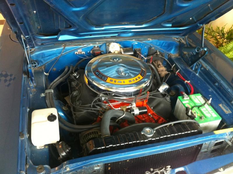

I ran into the same problem when I wanted to put the hemi in my 68 RR, I used a two speed wiper motor from my 67 belvedere race car that I took out. it lays down flat like the 3spd wiper motor, I screwed around with the wiring and got one speed to work, which is good enough for a car you usually don't drive in the rain. ( the 67 two speed is wired differently than the 68) at least I didn't have to go into the dash cause I didn't know if the harness would except the 3 speed switch.
