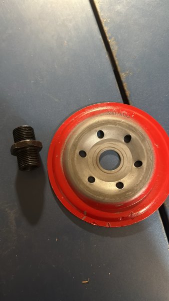

Pretty sure what I have is for Magnum applications. I mistakenly bought it for my 340. I’ll post a pic in a bit

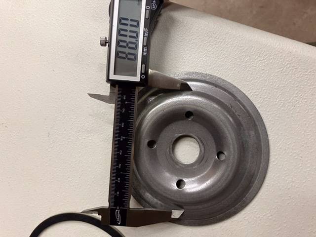

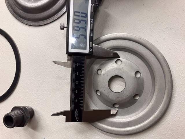

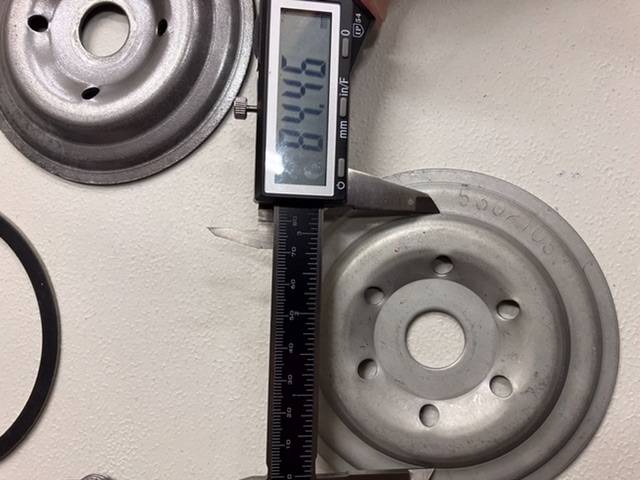

Turns out I have both types. The Magnum style is unused (Mancini MRE2402106 - has 6-holes). The LA style is used but in good shape (MRE2402103 - has 4 holes).

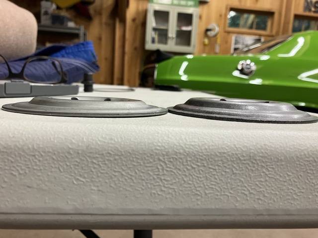

One more difference between the two plates. The Magnum plate (on left) is shallower.
