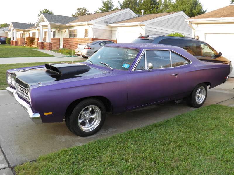

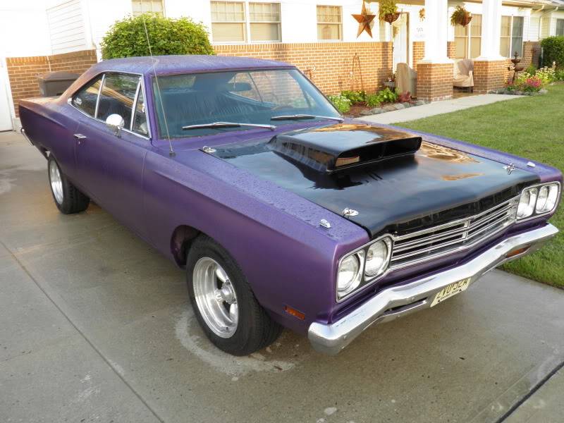

Just a quick wash to get the crud off her, got to dark when it was all dried, But here are the pictures i took right after i got her wet :jerk: Btw the windshield chrome is sitting in the garage all polished up.
Enjoy!

Looks nice, but what's up with the sway bar being upside down? Cool weather, Hooters girls, would be a nice scene, just sayin'!!
Yup....at least it looks that way to me too....nice car tho! It'll work that way but it just hangs down lower.....
I always thought it sat low, Thanks. How much of a PITA is it to flip?

BTW; is your paint a flat color on purpose?...I know a lot of people like
that look..

Thanks, Actually it wasn't on purpose, Kinda like it but my dad wants to spray it again, We'll see.
Great looking car--gotta be a lot of fun! BTW, it's an easy fix to turn your stabilizer bar over--4 bolts and it's done.
Thanks, I was afraid it had would effect the handling and need realigned or something. Good to know, I'll have to do. Kinda funny considering the guy i bought it from was a mechanic.
Btw took it to our local NAPA today and their painter told us our reducer was a fast drying and since we were painting outside we needed a slow reducer so we bought another gallon of clear and this weekend is suppose to get down in the 70's so we're going to spray it again.
