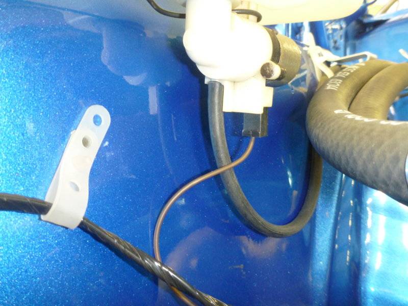

washer plug

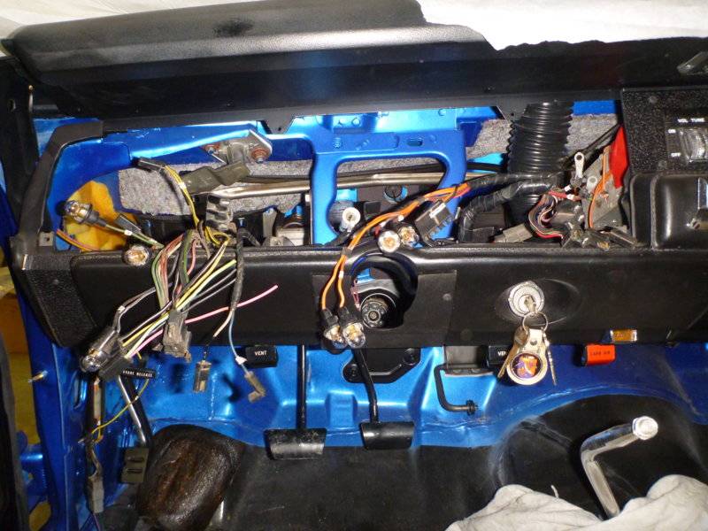

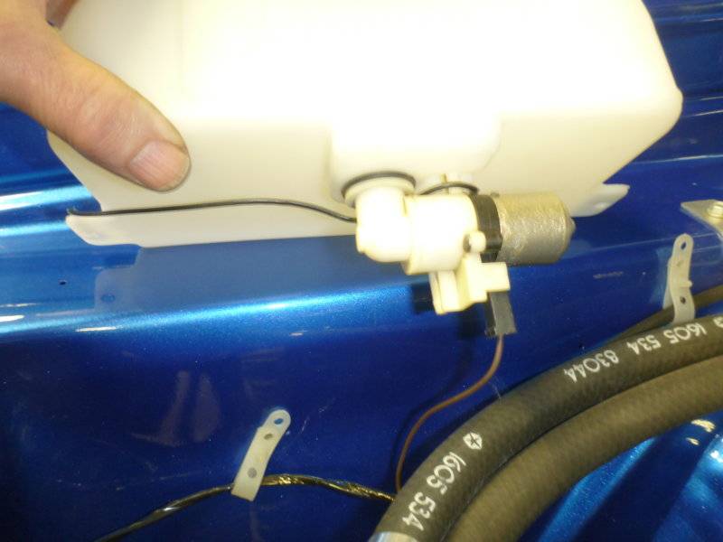

LOL.. looks pretty similar.. even brown wires. One jumps over from the wiper switch and the other goes to the bulkhead connector. I'll look to see if I took any shots..
Only shot I've got.. last two connectors on the right. You can see the brown wire on the furthest right and I believe the relieved one beside it is the jump to the wiper switch. The relief fits around the special tabbed spade..
So there should be three plugs,two on the washer switch and one goes to the wiper switch?
One brown (powered) jumper wire from wiper switch to washer switch... that's tied inside the harness (or originally was) and the output off the washer switch, also a brown wire, to the bulkhead connector. So yes I guess, three wire connectors, 2 on the jumper and one out to the bulkhead.
