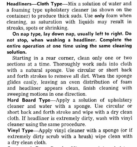

I don't know about washing the loose headliner, but if it was installed, here's the factory manual instructions on cleaning (for 1970)
