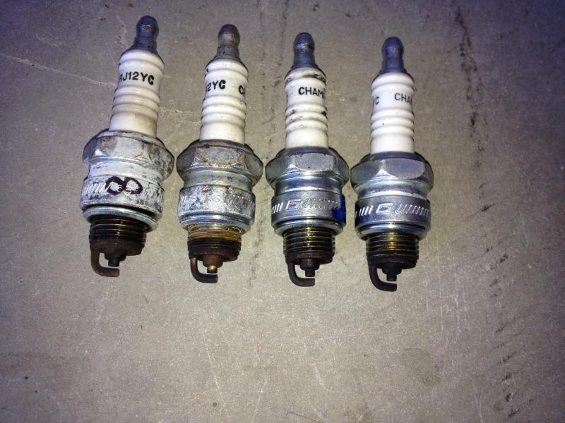

Pulled the plugs, #4 looked a lot cleaner than the other 3, but basically they all look like pretty normal burn.

Plugs look ok:

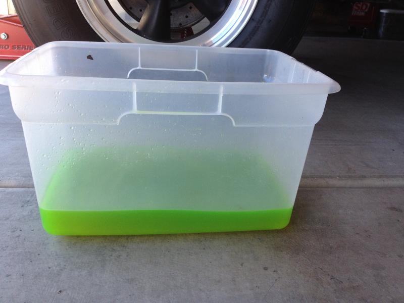

When I was talking the header bolts out of #2 and #8 a whole lot of coolant came out of the bolt hole:

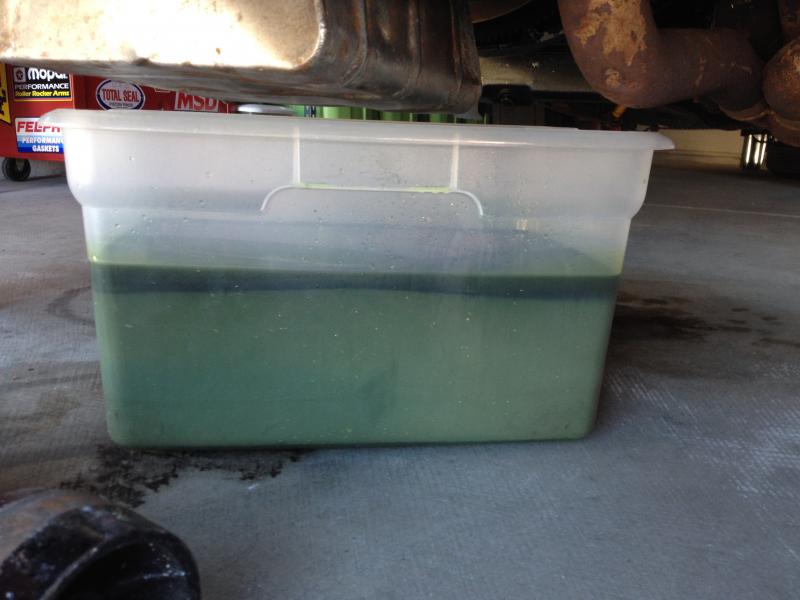

And this came out of the oil pan (it's 10+ quarts):IMG_0113.jpg

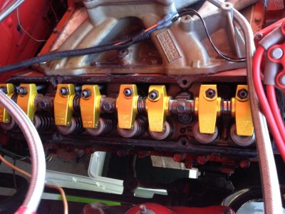

Good looking rockers though:
The header bolts go directly into the water jackets. No problem there. The oil/emulsified with coolant tells the story. Keep disasembling till you find it!
Thanks I didn't know the bolts went right into the cooling passages.
#6? (the one next to #8) looks cleaner than the others plus the upper part of the threads are discolored....looks like rust? Threads do not make a perfect seal and can compression will usually push water up and and out. Did you see any sign of water stains on the head like water was leaking out? The base of the plug looks a bit corroded but so does #8. Did the engine ever want to back against the starter?
#6 defalently had water in the cylinder. Water will clean all the carbon off of everything. Top of the piston, valves and the plug.
Hopefully just a head gasket...
#6 was barely hand tight. Motor always fired up easy and ran fine...... until yesterday when the trouble started. No evidence of coolant around the plugs except for the one plug being a lot cleaner.
