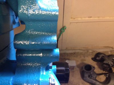

well, in the process of rebuilding the Coronet 440 and ran into a real issue. I bought a water pump housing, cast # 2780987 - 7 and compared it to the one off my 383 unit, 2780987, just to find out that it's an 8th in thicker? I thought all units with the same casting number were essentially the same? Major fitment problem with my pulleys ect........ 2014-03-24 09.15.54.jpg

I also have to belt-tension spacers that are different thicknesses as well and the between these two parts, one can make the correct fit, but I'll guarantee you that the -7 unit was mass produced this way with the shorter 1851608 spacer vs the 2806165 unit that came off the 383? Is this a 440 vs 383 thing?
...ok, so here's an interesting update. The difference is A/C vs non-A/C. The extra gap is related to the A/C bracket, I'v enever really compared these two before, but the fitment is exact. 2780987 - 7 is a non AC pump housing.
A/C non A/C are different animals!!

...yeah, and I'm a jackass for not figuring that out before I restored both parts, but I have a really nice non-A/C pump housing now.....

....roger that sir, and it's a real deal. A/C equipped cars used a thinner pump casting due to the brackets. There are some different casting symbols on the unit that came off my 67, but no other indicators......
