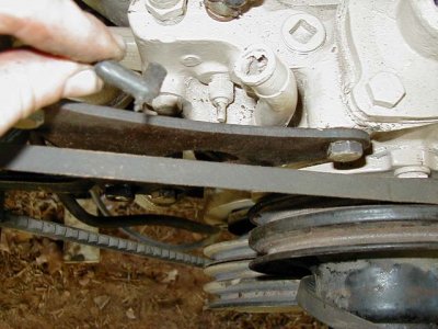

Hope this helps.
Yeah, that helps! Thanks! I thought that might be where it goes. So for an aftermarket gauge should I just put the wire terminal around that stud before I attach the factory gauge end?
The rubber boot came on the factory wire.But you can check junk yard you may find something off a car you can use.
That connector isn't something you will find easily. It's molded to the wire as part of the manufacturing process. The one in the first picture is pretty much the same as a Ford connector off a coil or something. I think the MoPar connector has a larger boot that goes around the whole sender.
Just to let you know, that an aftermarket electric temp sender will fit in the stock sender location if you don't want to use a mechanical one.

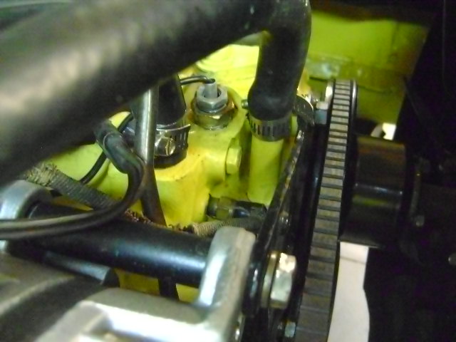

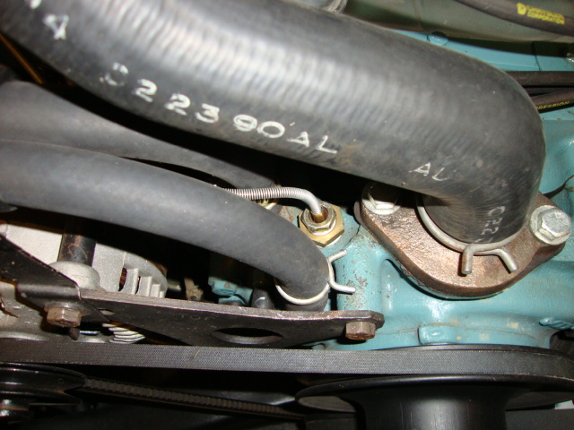

The aftermarket one is on top of the water pump housing between the radiator and heater hoses, and the factory one goes sideways and is behind the fan belt.
Here's mine...aftermarket...
