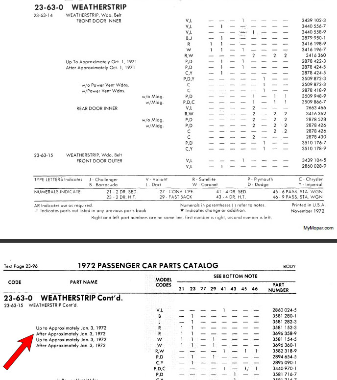

Not sure what the difference is, but I did a bit of digging and it seems I've found the date of the change:
The door outer weatherstrip had a production change in early January 1972. My car is a November '71 model, which of course means I'm up for the more expensive early strips. Sheesh.
I'll email MrMoparts to confirm and post their response up here.

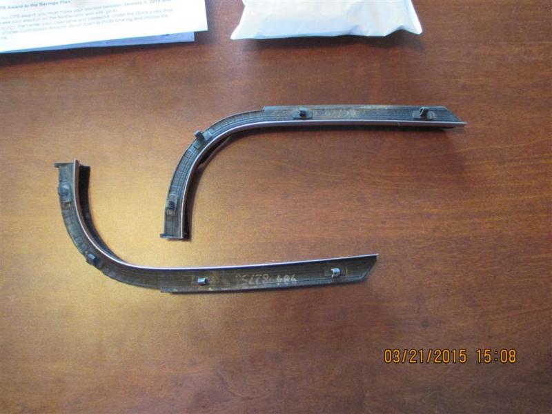

IMG_0681 (Large).jpgThe difference is in the inner quarter window pieces.
The early cars use longer ones and the later cars use the shorter ones.
My 72 with an SPD of 424 used the 10" ones.
Ron
^^^Thanks Ron :).
I can't see a change in the catalog for the rear quarter window strips, but perhaps I'm misreading it.
Michael from Mr Moparts just replied. He agrees I'll need the early version strips, but didn't elaborate on the differences between the kits.
