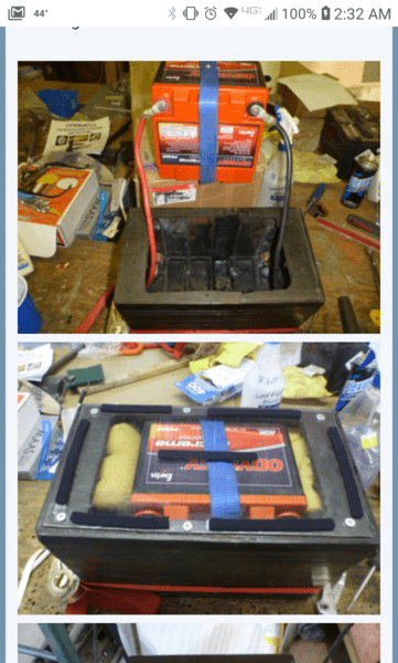

You can always replace the battery in the repro case @dadsbee

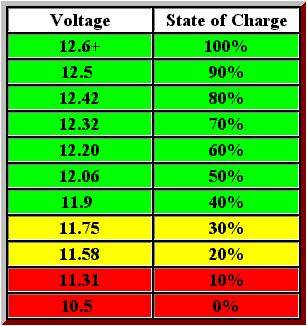

The only real way to test any battery is a LOAD test. A near dead battery, so dead that it won't do whatever job it is intended for, can and will still show rated voltage. It's when that voltage is combined with "motion" or "work" or "flow" aka current aka amperage that it will have a big drop.
Voltage is potential energy. When it is actually in use is when it can be gauged properly.

Interesting trouble & need a sanity test ! Try leaving Ignition switch in "Off" position & measure Battery voltage Directly at the + & -- battery Terminals for 12.6 volts..If ok, simply turn Headlites On. If Battery Terminals voltage stays at 12 volts, Battery Is OK & some combination of bad wiring connection (hi resistance) needs to be traced down & corrected.....tom.
