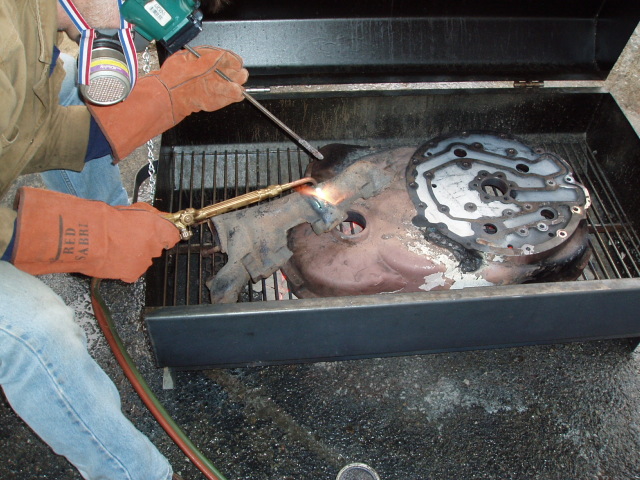

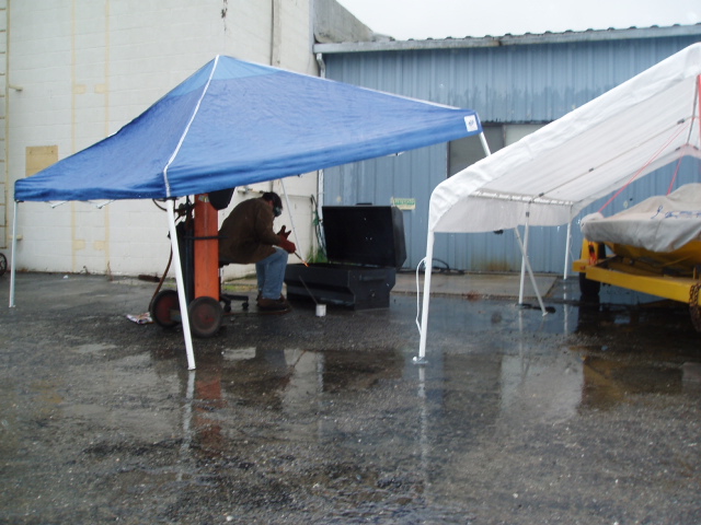

Well, the deed is done....outside in the rain and cold, wet feet, under a canopy with super assistant Mongo at my side.

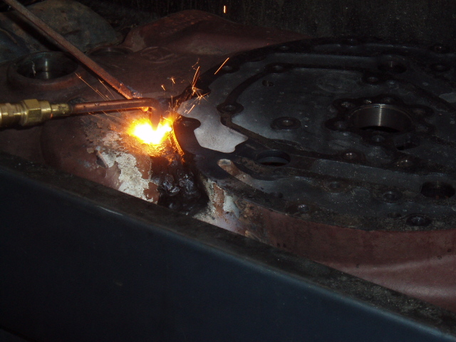

A bag and a half of Kingsford got that thing up to 450 F in less than an hour. The heat was even and eventually got to 560-ish when I started welding. The right rear got to about 750 while the weld area was about 900 or more. At that point I switched to the rosebud to heat up the back area to keep the delta T under control then changed back to the #2 and kept welding. My left hand started feeling a bit warm, particularly the pinkey finger, and when measured with the IR it was 280 F at the glove!! I need ceramic space shuttle gloves!! I started this about noon and when I left at 8:00 it was 470 F. I think its cooling nice and slow - just the way we like it. The BBQ did it's job perfectly so the question remains if the weldor did his....and I'm not claiming success until I find it's not broken or cracked worse than it was. Only one regret is we didn't have burgers ready!
The BBQ is a home made job that my buddy Marc folded up in about 5 mins - probably while half asleep and watching Iron Man (yeah, he's that good). This thing went from concept to lighting the Kingsford in less than two days. Building this reminds me of working at the lab - except the part where it takes six months, three engineers and 47 design and safety meetings to build.
The filler material I used is a special poured cast rod that you use with flux. Very slow process but it works great. I say go for it! Fix those broken HEMI manifolds in your BBQ!
Just thought I'd share an interesting experience.

What IS that you're welding? A couple questions after you heat that and let it cool doesn't it make it softer and need to be reheated and cooled again? Also where I work they weld cast iron all the time with out preheating it. One part has a robot doing it with a mig of some type.
I have no idea other than it's a $3000.00 transmission case from some tractor. Yup, I was sweatin' it! The other part is a 390 GT manifold.
The thing I was always told about cast iron is to preheat it and cool it slow so it doesn't crack and I never heard anything about heat cycling it after the weld. I think it's pretty stable stuff if you treat it right. Maybe it depends on the grade of iron on how much you can get away with, but I didn't want to take the chance.
The common way to weld it is to arc weld it using a nickel filler rod but you are limited to short welds because the nickel does not expand and contract at the same rate as the iron, and on cool down there will be unequal stresses that can cause problems. I ran a pass on an old brake rotor using the nickel rod and no preheat and the weld bead just peeled right off and took some of the iron with it! I'd be interested to know what kind of cast material your guys are welding and also the process. I used to run a vacuum brazing shop for a national lab and had to deal with different materials at high temps all the time, but that doesn't make me an expert in welding. The cast rod should be a dead on match regarding materials and the softer gas flame should be nicer to the part during the process. Try it out!
