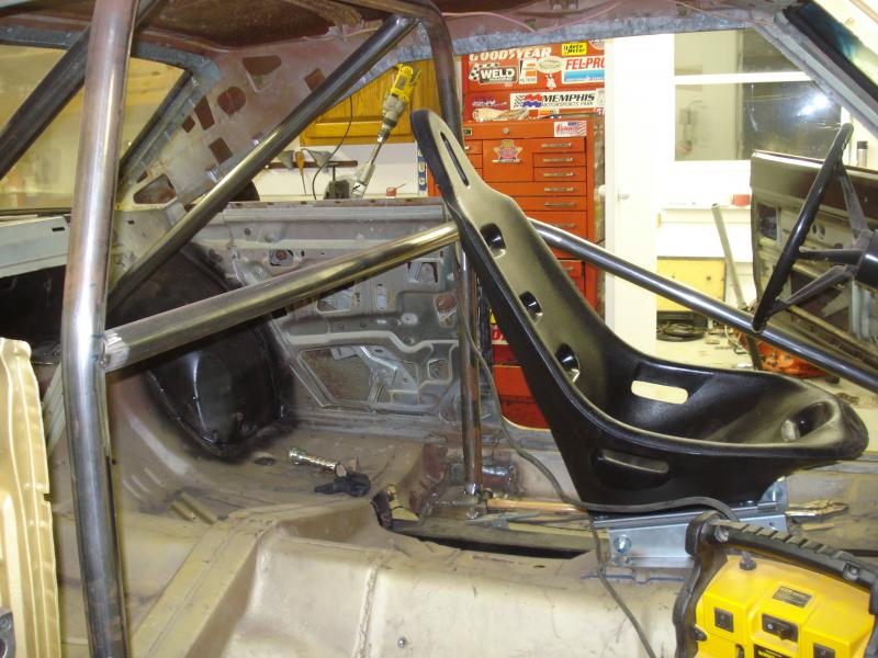

Hey guys,
Just got done putting in a roll bar in my 67 Coronet and I kept having issues with my welder, was looking to see if you guys might have an idea on what may be my issue because I haven't ran into this before... When I'm welding everything is clean and good to go, as soon as I start the welder it'll stop making any noise ( I.e. No "bacon cooking" sound, just silence, maybe even like a whisper sound) even though it is welding and a tear drop of metal starts to form on the end of the wire that is being fed though the gun... Sometimes it'll just pool up and fall right off of what I'm welding. Any ideas on what I'm doing wrong? Welds seem like they don't want to sink into the metal.
Machine is a 140 Pro MIG made by Lincoln, Using .030 wire w/ 75 Argon - 25 CO2

Hey guys, thank you for all the posts! Got out in the garage first thing this morning and started messing with it. I cleaned out the machine as well as the gun/wire liner. Put everything back together, readjusted the tension spring and started doing some practice welds on some scrap rollbar I had. No issues. Welds beautifully. Might of been some kind of dirt in the liner or else I had the wrong tension set... Either way its all good to go now, actually got my bar welded up today and just started to patch the floor back up when I ran out of shielding gas... I'll post pictures a bit later once I get my camera out of the garage!
